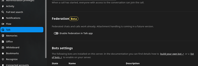

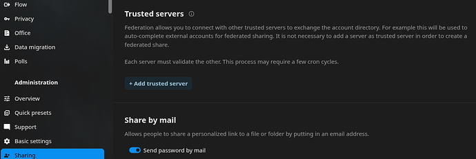

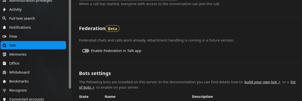

Can you share some details here? What exactly did you do?
Experience from a pretty good while ago - just for the case it may help: I had 2 Nextcloud bare-metal installations on either same version. I connected one to the other via federation feature. What I experiences is: As soon as one of the 2 becomes offline or has connection issues, the other instance does not work either any more. It looked to me as long running directory listing queries. That’s why I disconnected the two instances again and use them separately. I was searching for a synchronisation solution to implement a hot standby backup, so the federation feature was did not help me anyway.
Problem still persists.
I added the federated server here before.
And enable Talk federation
These functions are disabled now.
I didn’t experience any problems before turning on Federation for the first time. Turning it on changed something that affected the rest of the functionality.
Disabling both features only alleviated the symptoms but didn’t eliminate them.
