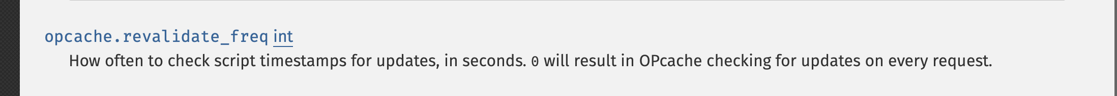

No, I know how config works. No, I do not have any other file in the /config folder (apart from .htacccess and MIME mapping). No, I do not backup to the same folder. My opcache revalidation time setting is 0 on purpose. This setting checks the timestamp on every request. Should the timestamp be unchanged, the file is served from cache, however all new files from an upgrade package (including config.php) have timestamps different than the previous version of NC, so no cached old files can are served. BTW I follow the best practices and stop both the webserver process and the php8-fpm service before upgrading, so opcache is cleared and starts fresh anyway.
No, that disables checks entirely.
EDIT: To clarify we may be talking about slightly different things. To be more specific, the combo of opcache validations options is what matters. I’m thinking of opcache.validate_timestamps. If that is 0 for example, then opcache.revalidate_freq is ignored.
Not when checks are disabled.
One cause of what you’re seeing would be that the old installation’s version.php is being picked up still.
It doesn’t start fresh per se. As soon as you start them back up to run the Updater, the existing (old) code loads.
In any case, based on your described config, at a minimum you’d have to restart php-fpm manually after the upgrade.
From the very link you have provided (PHP: Runtime Configuration - Manual):
I would appreciate if you familiarized yourself with the matter before shooting in the dark and giving “advice” you are clearly not ready to give.
As I stated in my follow-up:

While it is the opcache.validate_timestamps that actually enables and disables opcode cache, it wasn’t even mentioned and you stated that it is a 0 in a different directive that does this, which was misleading. This value is set to ‘enabled’ by default, BTW.
So you might have guessed that if I say “deliberately 0 because checks on every request”, the cache is enabled. It would not make any sense if I set the revalidation time to 0 and disable the cache. We have never mentioned the other directive before.
Also, even if you set the revalidation time to any number but disabled the opcode cache altogether by setting opcache.validate_timestamps to 0, the revalidation time does not apply so there is no “specific combo” as you tried to backtrack from a missed shot. It’s a different directive altogether that turns cache on and off and opcache.revalidate_freq has nothing to do with it.
