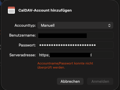

I did like:
I also tried the following combinations
Nothing of these options/combinations work.

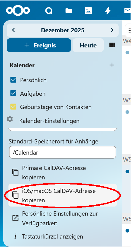

Login in browser to your Nextcloud
Select “Calendar”
click “Calendar-settings” in the lower left corner and scroll down the menu at the left border:
Use that link.

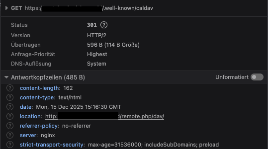

The redirect is working. Proof in Firefox:
It looks like that MacOSX accountsd is not following the location. Because I can see Firefox following the URL:
[15/Dec/2025:15:16:30 +0000] “GET /.well-known/caldav HTTP/2.0” 301 162 “-” “Mozilla/5.0 (Macintosh; Intel Mac OS X 10.15; rv:146.0) Gecko/20100101 Firefox/146.0”
[15/Dec/2025:15:16:30 +0000] “GET /remote.php/dav/ HTTP/2.0” 200 111 “-” “Mozilla/5.0 (Macintosh; Intel Mac OS X 10.15; rv:146.0) Gecko/20100101 Firefox/146.0”
Maybe it needs to be a rewrite and no redirect.

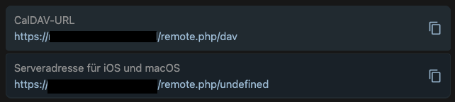

Unfortunately, the URL is “undefined” in my installation. I guess its old or broken:
Can you send me the anonymized address of yours for comparison?
On my server (Nextcloud 31.0.12) it is
https://myserver.de/remote.php/dav/principals/users/username/
But I am not sure, that this also will work in your configuration.

According to your Firefox screen the redirect target is http://. The docs say macOS doesn’t support http:// for CalDAV in the troubleshooting section.
Can you fix that matter then recheck?
Thanks for the hint. I see now, that the location redirects to http instead of https.
I have the configuration for NGINX based on NGINX configuration — Nextcloud latest Administration Manual latest documentation
Nginx is running on port 80, so it’s an issue in my configuration, or the helm chart. Let me check that.
I fixed the Helm chart to respect the `X-Forwarded-Proto` header from Ingress. Now it works also with MacOSX accountds in Manual setup mode.
