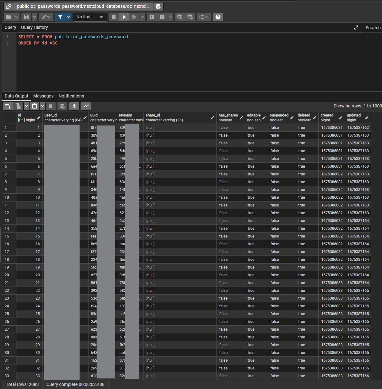

Recently migrated from a non-AIO instance to AIO. After the migration of the database, all works except Passwords.
I have no idea if it’s because if it’s not yet supported my NC 32 or encountered issue during the migration process.
I could see all entries on the table with the help of pgAdmin though.
After checking, the other thing that I got access to is files under autoBackups folder.
No idea how to restore

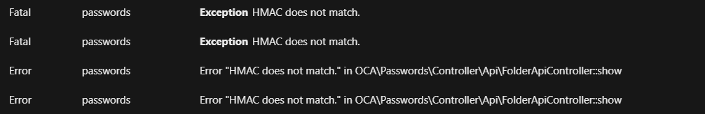

So first, the app is compatible with NC 32 and has been since launch. Please install the version for NC 32.
The reason you can’t use the app is that you migrated to another server without keeping the secret from the old one. Because of this, the data can’t be decrypted anymore.
If you still have the config.php file from the old server, you can get the secret from there and store it as passwords.secret in the config.php on the new one.
If you don’t, here is the wiki entry for backups: Backups · Wiki · nextcloud / passwords · GitLab

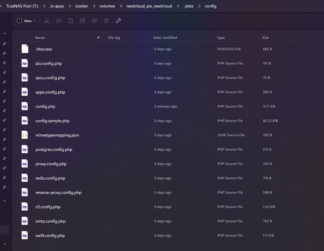

Hoi @mdw !
Just found config.php by myself.
After quite some time of learning/digging into Docker, finally found how/where to find docker volumes.
Should have told me that is mounted as docker volume not as mountpoint/hostpath.
I might want to set nextcloud_aio_nextcloud, nextcloud_aio_database all related volumes to a mountpoint.
