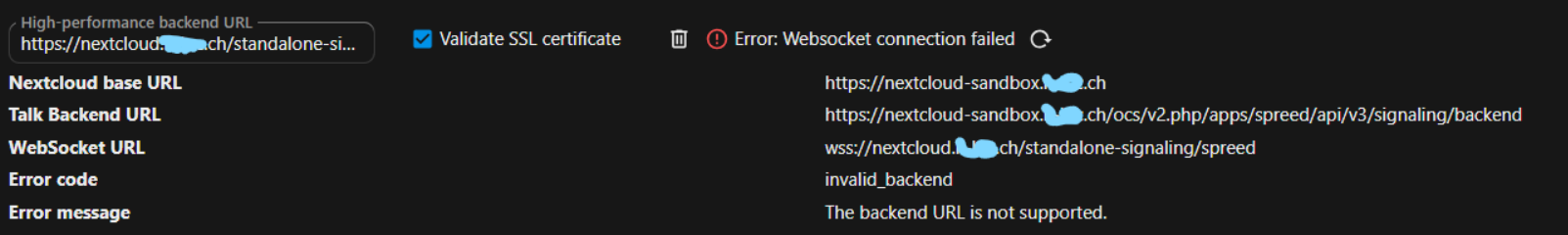

Among further troubleshooting by deploying an AIO sandbox, found out that the shared password under WebSocket URL should be SIGNALING_SECRET from configuration.json.
On the sandbox, I changed one character of the shared secret, then became unusable which is expected by me.
After entering the correct SIGNALING_SECRET on the prod instance, the issue still persist

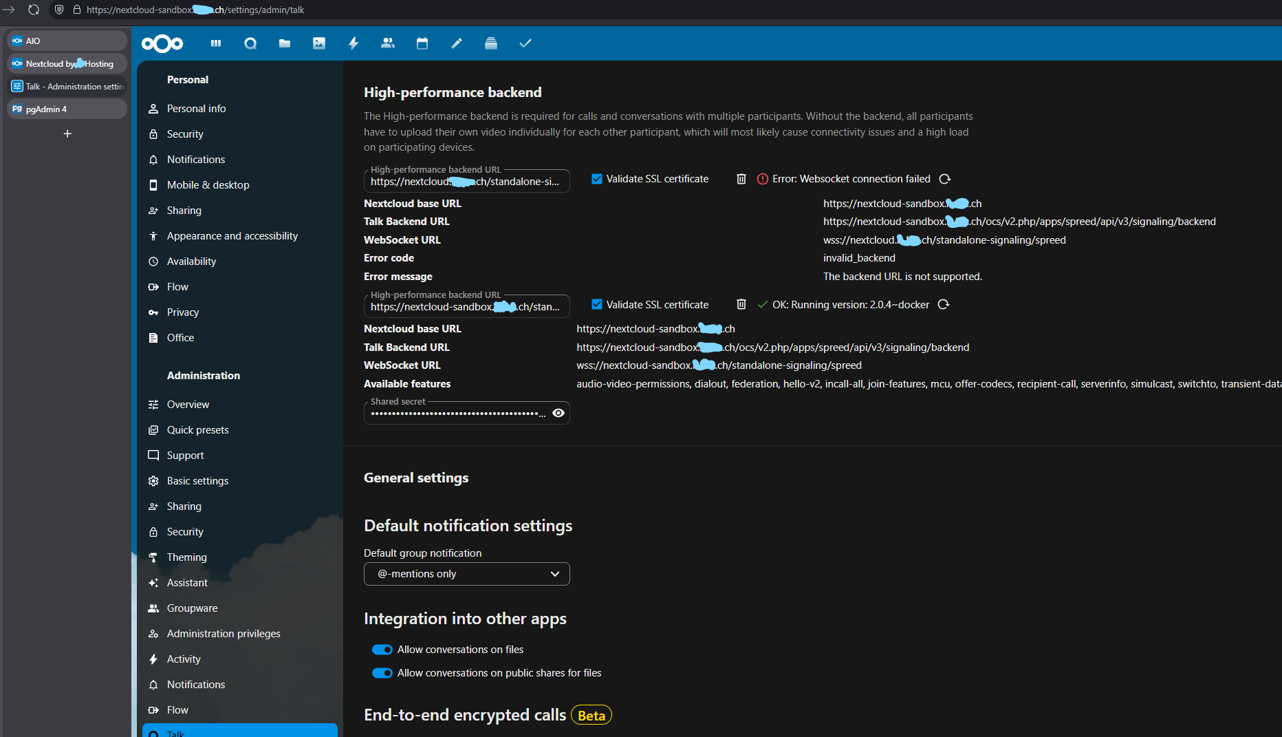

Further investigation:
I restored the database to a working sandbox instance with another subdomain, noticed that after restoration of the db all settings of Talk got rewritten.
After modifying the URL on the sandbox to reach sandbox’s instance, talk went back to be usable.
I might follow that path by backup Nextcloud in production database, clean it, redeploy with another temporary domain, do what mentioned above to restore, then finally redo everything with the production domain.
Or someone might have a shortcut?
Hi, simply remove this not-working backend?
This only works when the database is overwritten with the wrong url.
While overwritten the backed up DB from nextcloud.<my_domain.com> over to nextcloud.sandbox.<my_domain.com> then delete the non working URL through Nextcloud’s settings. After that it automatically reset back to the working config.
