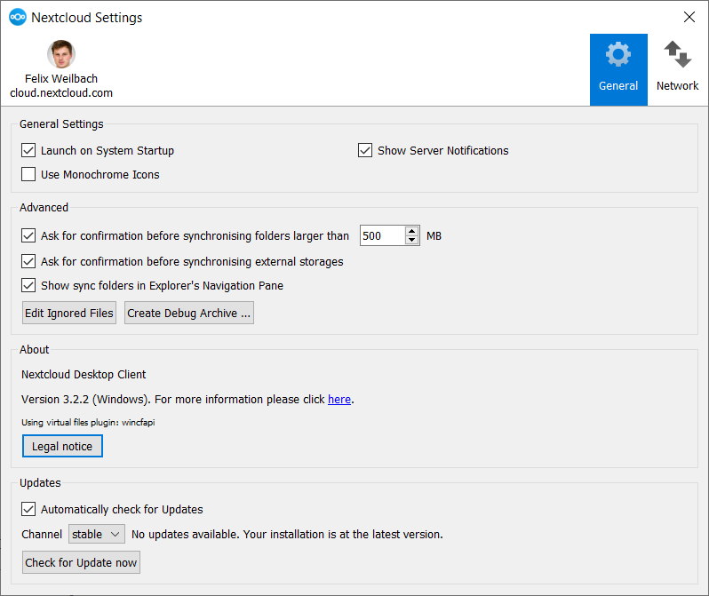

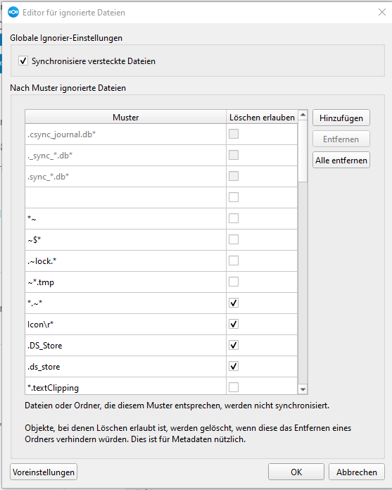

reading the docs, this could be what you’re looking for?
yip, this is what you’re looking for, global ignore lists:

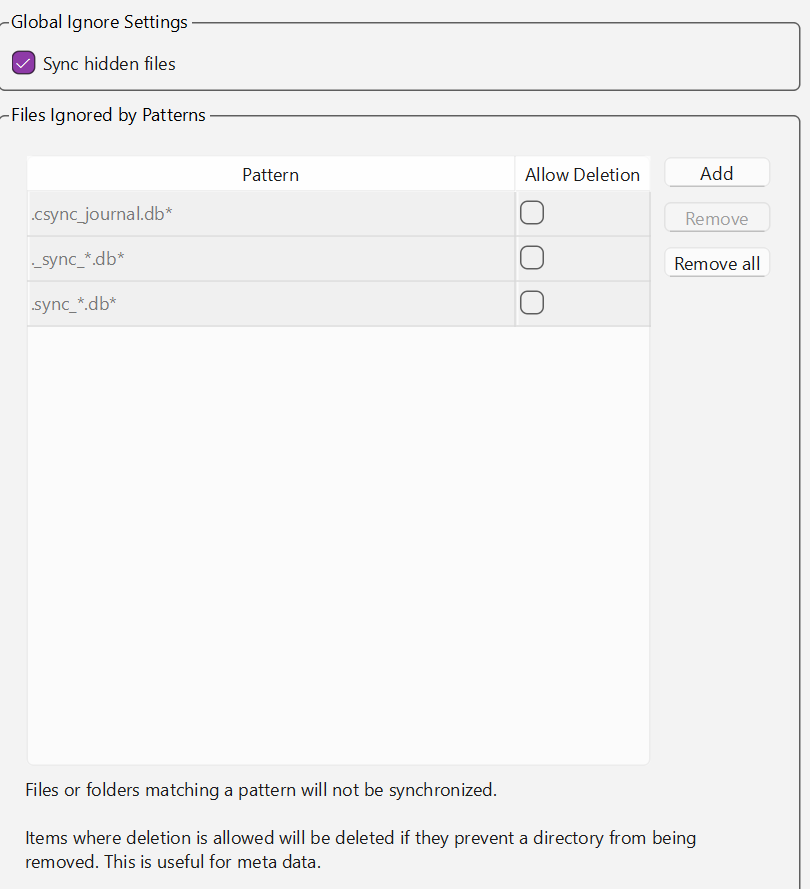

My Ignored file setting:
Win 10 and 11 and WEBDAV.

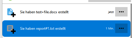

here is mine:
Also tried from the WEB:
