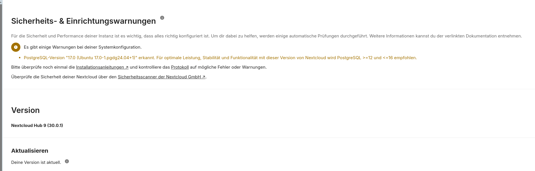

Is anyone on the way with NC29 / 30 combined with latest stable PostgreSQL 17?
Allthough there is a warning - when trying to use PostgreSQL 17 database with Nextcloud (…30), is somebody on his way migrating the previous pgsql 16.x main to 17 main?
What are the expectable problems ? Or if there are no serious probs - what can be done to suppress the warning in the admin settings?

I just tested a migration to verify that it is possible. Never the less the warning in NC 30 using a db not inbetween >=12 and <=16 came a little bit surprisingly.
The last migration from 15 to 16 doesn’t give any warnings or restriction hints - maybe NC has been sufficient developed to support the 16 main version that moment postgresql has been released it’s new main version.

The thing what’s being left over is the warning after integrity check
Thanks so far - hope that in next point release there will maybe an update (suppress) for that message …
upgraded to the 30.0.2 and remarked that the warning about using a PostgreSQL database higher than v 16 is still there.
The feedback for PG17 on github is positive - and for me no errors nor performance issues so far as well.
Is there an option / parameter etc. to set the range higher than 12 → 16 manually?
