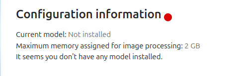

i have nextcloud installed via snap and i installed face recognition directly from the nextcloud app store.
i managed to allocate 2gb of ram for processing but i can’t install the modules. from my research, i found out that i don’t have pdlib installed.
all the methods i tried to install pdlib have failed.

same issue as Recognize app error , same solution…
you should consider a different solution if you’re keen on tensorflow and node.js dependant apps… these are “programs” that need to be executed within the snap and are not bundled within the snap.
… require Node.js 20, which in turn requires a version of glibc >= 2.28 (more context here ). The nextcloud snap is still using glibc 2.27 (from core18), so Recognize’s WASM mode won’t work with the snap till this issue is solved.
see also what is snap confinement
