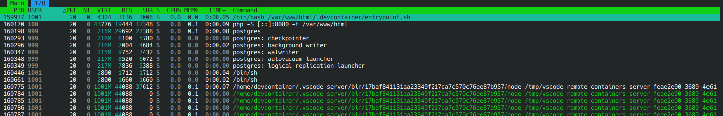

In addition vs code can’t list the running containers after being opened in container mode… Which led me to the discovery that a lot of the devcontainer stuff runs as user 1001, which does not exist on my system (my user is id 1000)
It all does sound similar to the issue you link, but I’m not sure I understand how to fix it… The user inside the container is “ubuntu” which I guess maps incorrectly to 1001 instead of 1000 on host…
The postgress container seems to run with the user 999 which also seems bad…
