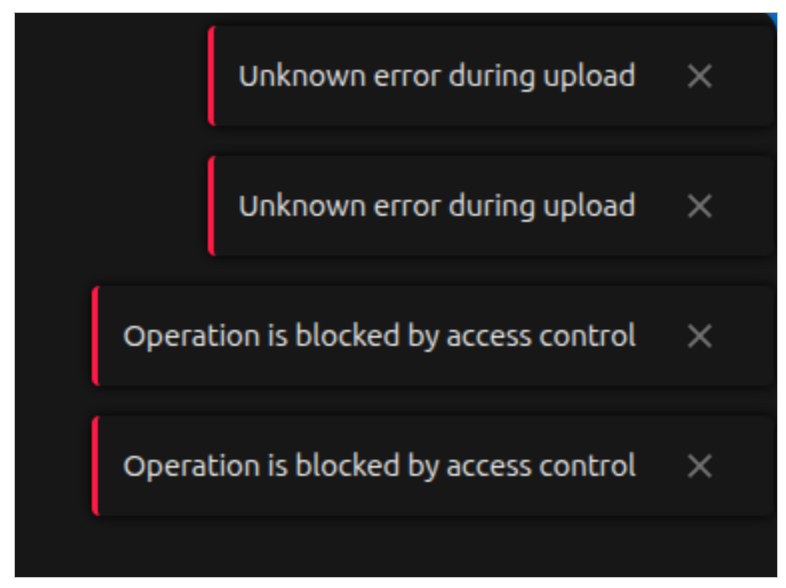

When I attempt to upload even very small files to an external storage folder, I get the following error messages: (1) Unknown error during upload and (2) Operation is blocked by access control (see screenshot below). It’s worth noting that I have not installed the File Access Control app, so that app can’t be the cause of these errors.

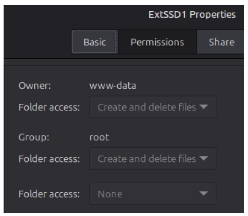

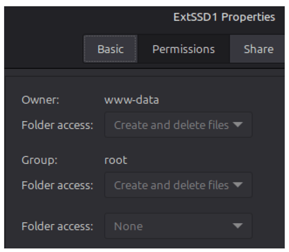

    I then tried tweaking these settings further within Linux Mint, but I don’t think that made a difference. Here’s what my Permissions settings look like for this folder:
    Note that both www-data and root are able to create and delete files within this folder.
    In addition, running sudo -u www-data ls -l /media/ExtSSD1 within my Linux Mint terminal (as suggested by @tflidd in this post) allows me to see the contents of this folder–so I don’t think the permissions issue is on Linux Mint’s side.

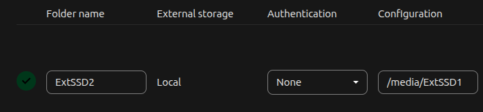

  5. I enabled the External Storage app; then, within my administrator account, I created a new external storage entry. I chose EXTSSD for the folder name, ‘Local’ for the external storage type, ‘None’ for the authentication method, and /media/ExtSSD1 for the configuration setting. I also gave access rights to my administrator account and my personal user account. I saw a green checkmark to the left of the entry after I completed these steps.

A quick update: When I tried connecting a new hard drive and following the above steps (including the container restart command), I was able to add and remove new files but couldn’t access existing files. To resolve this, I tried out a few different steps, including:
  1. Selecting the hard drive’s properties within Nemo (Linux Mint’s default UI); going to ‘Permissions’; and hitting ‘Apply properties to enclosed files.’ I don’t think this was really necessary, since my understanding is that the -R flag in the original terminal commands would already have applied the correct permission settings recursively, but it probably didn’t hurt either.
  2. Stopping, then restarting all containers.
  3. Going to Administration Settings → Administration → External storage; clicking the 3-dot button to the right of the drive entry; selecting Disconnect; and then reconnecting the drive. (I think this step alone might have solved my issue, though the second step, and possibly the first, may also have helped.)
