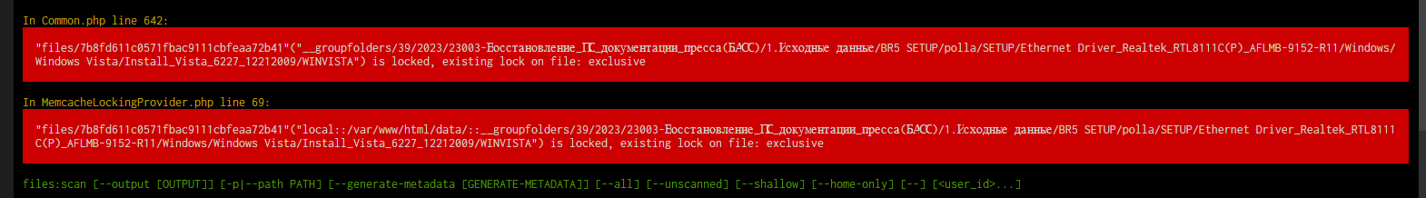

D:\NC-orokez\02 ENGINEERING\01 PROJECTS\2023\23003-Recovery_of_press_documentation_software(rcvr)\1.Initial data\BR5 SETUP\polla\SETUP\Ethernet Driver_Realtek_RTL8111C(P)_AFLMB-9152-R11\Unix (Linux)\Linux driver for kernel 2.6.x and 2.4.x (Support x86 and x64)\r8168-8.006.00\src

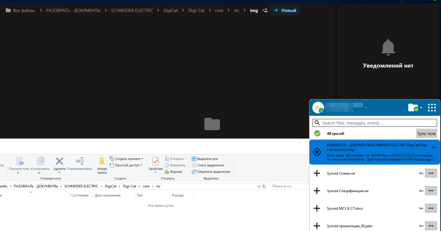

I cannot delete some folders inside the group folder. I have write and delete access.
I delete via the web, when synchronizing the client, an error appears “temporary error when removing local item removed from server”. I delete from a PC, from different clients of version 3.16.6, but the folders still reappear. I rename - a duplicate with the original name is restored.

There were suspicions that the folder path was too long, but if I do the same thing on my personal nextcloud cloud, then everything works fine.

The “rsc” folder cannot be deleted—neither via the PC nor through the browser. When attempting to copy the “SCHNEIDER ELECTRIC” folder to another location using the browser, an error occurs.

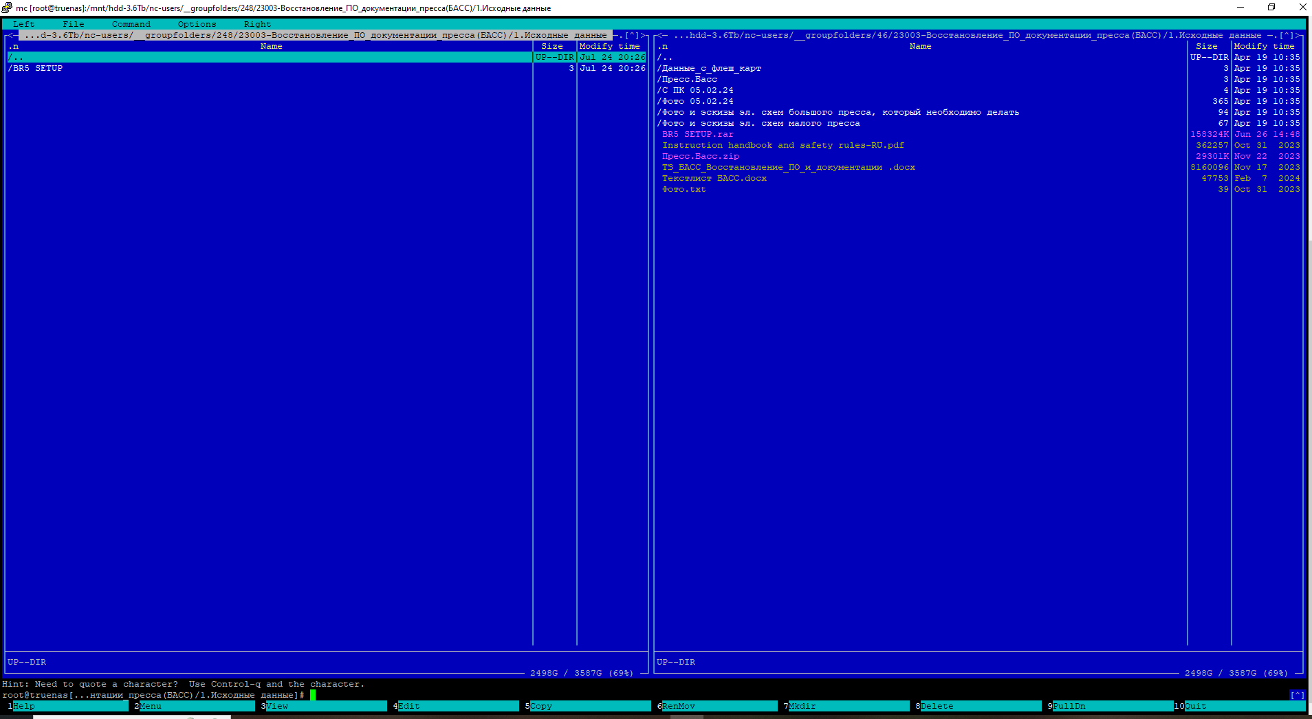

when viewing folders directly from under the OS, it is clear that the copying was not completed, and the copied files did not appear in the NC database.

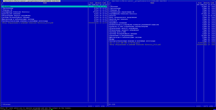

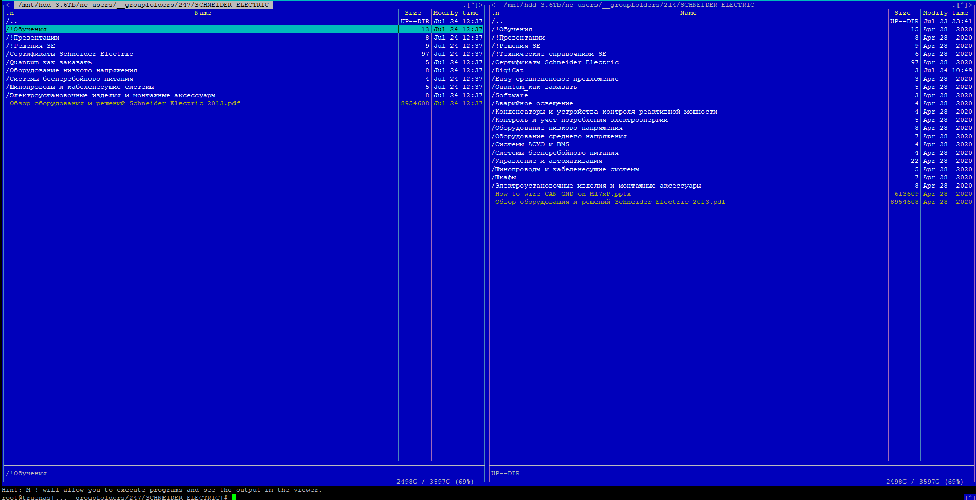

I have disabled access to the problematic shared folder for everyone.
I have created a new, empty groupfolder with the same name as the original one. After granting myself access, I noticed that the non-removable folders were still present.
In the screenshot, on the right side, there is a restricted folder that cannot be deleted. On the left side, there is an empty folder that I created. As soon as I granted myself access, the non-removable folders appeared in the new folder.
