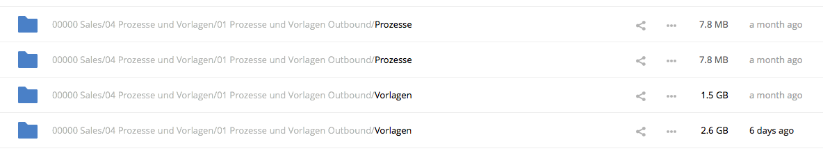

We have the problem that in some folders, all the files and sub-folders are shown twice in the web user interface, sometimes with conflicting information about the size or modification date, see the following screenshot:
I tried to run occ files:cleanup
as well as occ files:scan --path="/user/files/00000 Sales"
, but it did not change anything.
We had problems with file staying locked, so I enabled memory caching (redis) for content and file locking, and cleared the oc_file_locks
table in the database, but that didn’t change some files and folders being shown twice.
How can we fix this?

Well, every time I visit the folder in the Web UI, I see the fies/folders twice. But I have no idea how to reproduce it in new folders.
The issue you are facing:
It’s very confusing for users of the web interface
