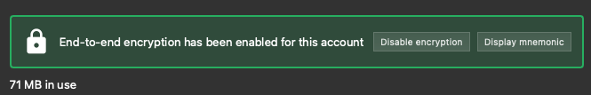

Same exact issue here. Encryption and sync works fine on macOS, but I can’t enable it on iOS client. Nothing in the log file on the server nor in the client itself
EDIT: Note that if I reset the encryption in the Web UI and initialize it on the iOS instead of desktop, everything works fine. I can then take the mnemonic and setup encryption in desktop app as well.

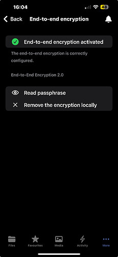

I created the mnemonic passphrase through the iOS app but I’m having the same issue.
{"reqId":"aCyhOSLCBLBi0js6QxD8DgAAANE","level":2,"time":"2025-05-20T15:35:21+00:00","remoteAddr":"2a02:3100:8415:c200:1176:f08d:5277:bcf2","user":"redacted-user","app":"end_to_end_encryption","method":"GET","url":"/ocs/v2.php/apps/end_to_end_encryption/api/v1/private-key","message":"Could not find the private key of the user: redacted-user","userAgent":"Mozilla/5.0 (iOS) Nextcloud-iOS/6.6.2","version":"31.0.5.1","data":{"app":"end_to_end_encryption"}}
{"reqId":"aCyl0_qh0Q1d9n_Z1rHCxgAAAI0","level":3,"time":"2025-05-20T15:54:59+00:00","remoteAddr":"2a02:3100:8415:c200:2df0:bcad:e59:be0e","user":"redacted-user","app":"end_to_end_encryption","method":"DELETE","url":"/ocs/v2.php/apps/end_to_end_encryption/api/v1/encrypted-files","message":"No file for owner with ID 1103","userAgent":"Mozilla/5.0 (Macintosh; Intel Mac OS X 10_15_7) AppleWebKit/537.36 (KHTML, like Gecko) Chrome/136.0.0.0 Safari/537.36","version":"31.0.5.1","exception":{"Exception":"OCP\\Files\\NotFoundException","Message":"No file for owner with ID 1103","Code":0,"Trace":[{"file":"/var/www/virtual/redacted-user/html/nextcloud/apps/end_to_end_encryption/lib/MetaDataStorage.php","line":147,"function":"verifyOwner","class":"OCA\\EndToEndEncryption\\MetaDataStorage","type":"->","args":["redacted-user",1103]},{"file":"/var/www/virtual/redacted-user/html/nextcloud/apps/end_to_end_encryption/lib/Controller/EncryptionController.php","line":97,"function":"deleteMetaData","class":"OCA\\EndToEndEncryption\\MetaDataStorage","type":"->","args":["redacted-user",1103]},{"file":"/var/www/virtual/redacted-user/html/nextcloud/lib/private/AppFramework/Http/Dispatcher.php","line":200,"function":"removeEncryptedFolders","class":"OCA\\EndToEndEncryption\\Controller\\EncryptionController","type":"->","args":[]},{"file":"/var/www/virtual/redacted-user/html/nextcloud/lib/private/AppFramework/Http/Dispatcher.php","line":114,"function":"executeController","class":"OC\\AppFramework\\Http\\Dispatcher","type":"->","args":[{"__class__":"OCA\\EndToEndEncryption\\Controller\\EncryptionController"},"removeEncryptedFolders"]},{"file":"/var/www/virtual/redacted-user/html/nextcloud/lib/private/AppFramework/App.php","line":161,"function":"dispatch","class":"OC\\AppFramework\\Http\\Dispatcher","type":"->","args":[{"__class__":"OCA\\EndToEndEncryption\\Controller\\EncryptionController"},"removeEncryptedFolders"]},{"file":"/var/www/virtual/redacted-user/html/nextcloud/lib/private/Route/Router.php","line":307,"function":"main","class":"OC\\AppFramework\\App","type":"::","args":["OCA\\EndToEndEncryption\\Controller\\EncryptionController","removeEncryptedFolders",{"__class__":"OC\\AppFramework\\DependencyInjection\\DIContainer"},{"apiVersion":"1","_route":"ocs.end_to_end_encryption.encryption.removeencryptedfolders"}]},{"file":"/var/www/virtual/redacted-user/html/nextcloud/ocs/v1.php","line":49,"function":"match","class":"OC\\Route\\Router","type":"->","args":["/ocsapp/apps/end_to_end_encryption/api/v1/encrypted-files"]},{"file":"/var/www/virtual/redacted-user/html/nextcloud/ocs/v2.php","line":7,"args":["/var/www/virtual/redacted-user/html/nextcloud/ocs/v1.php"],"function":"require_once"}],"File":"/var/www/virtual/redacted-user/html/nextcloud/apps/end_to_end_encryption/lib/MetaDataStorage.php","Line":287,"message":"No file for owner with ID 1103","exception":{},"CustomMessage":"No file for owner with ID 1103"}}
{"reqId":"aCymB_qh0Q1d9n_Z1rHDNwAAAIo","level":2,"time":"2025-05-20T15:55:51+00:00","remoteAddr":"2a02:3100:8415:c200:1176:f08d:5277:bcf2","user":"redacted-user","app":"end_to_end_encryption","method":"GET","url":"/ocs/v2.php/apps/end_to_end_encryption/api/v1/private-key","message":"Could not find the private key of the user: redacted-user","userAgent":"Mozilla/5.0 (iOS) Nextcloud-iOS/6.6.2","version":"31.0.5.1","data":{"app":"end_to_end_encryption"}}
