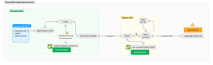

I’m still having hard time to understand your config. would be great you create a drawing to explain such complex setup.
what I get is (correct me it I’m wrong)
  • your docker host has 10.8.0.2
    • on this host you run AiO and Caddy (what is purpose for Caddy?)
  • your VPS has Wireguard tunnel with docker host
I understand the Caddy config like this
  • listen on http://10.8.0.2:12000 → reverse_proxy http://127.0.0.1:11000
  • listen on https://localhost:11000 → reverse_proxy http://127.0.0.1:11000
  • this makes me think there is an address conflict with Caddy and AiO Apache on port 11000
I have the feeling Caddy is more or less useless in this setup isn’t it? I would setup VPS Nginx to connect with AiO Apache on :11000

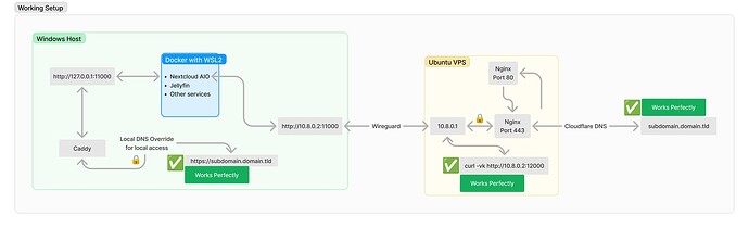

Hi!
First of all thank you so much for helping. It works now! I’ll explain in detail so whoever stumbles upon this problem might find it helpful.
TL;DR
I’m 90% certain the problem is #2 and #3. Things that changed:
  1. Updated Nextcloud v10.2.0 → v10.3.0.
  2. Issues with Caddy & Nextcloud conflict on :11000 port binding.
  3. APACHE_IP_BINDING to 0.0.0.0. I have tried this in the past with and without Caddy, maybe it wasn’t applied properly.
Here’s a diagram I created on my faulty setup:
In theory should it work though? I am just curious what’s with the content-length: 0.
To answer your questions:
  • Caddy reverse proxy:
    1. is used for local access mainly. I want to reach my own server when I’m at home without reaching the internet.
    2. Secondly, my VPS responds with connection refused. That’s why I thought Caddy was necessary. Please see my other diagram below with Caddy from external access removed.
The issue I think is Apache is not binding to the right IP or Caddy port :11000 conflict. After changing the APACHE_IP_BINDING env to 0.0.0.0 again and removing that part from Caddy works flawlessly.
Once again, thank you for your help!
very cool, thank you for detailed drawing, I think this really helps others :handshake:
