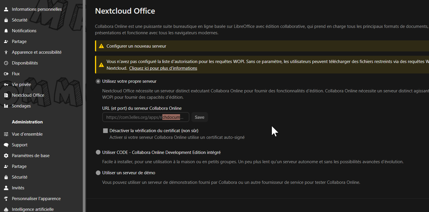

hello i try
but after save config i already redirect to use code

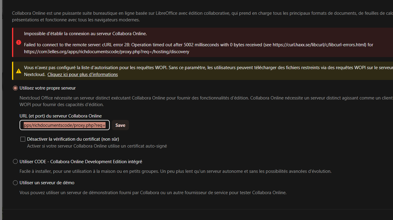

https://mydomain/apps/richdocumentscode/proxy.php?req=/hosting/discovery => doesn’t work i have an infinit loop
i didn’t find any solution for this
when i try to check Nextcloud Office configuration in order to add wopi
i have this message
Failed to connect to the remote server: cURL error 28: Operation timed out after 5002 milliseconds with 0 bytes received (see libcurl - Error Codes) for https://com3elles.org/apps/richdocumentscode/proxy.php?req=/hosting/discovery
and what is the difference between this two?
I didn’t find why last url do a loop ça realy strange
