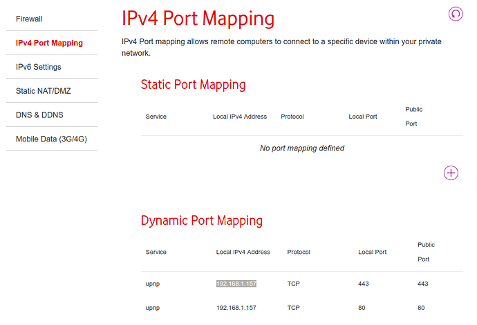

Can't connect externally to nextcloudpi
Having failed to get Nextcloud to run on a Virtual Machine, I’m now failing on a Raspberry Pi4 instead! This seems crazy hard to get work!
Actually, I have finally managed to get NC to run on the machine (that was easy, just flashed an SD card with the image and it ran straight away) and I can access it on the local network, but I can’t access it externally, I’ve been following the guide here. I have my domain unchained.timbilt.co.uk registered with FreeDNS. I have run nc-forward-ports in the configuration dashboard and this appears to set up correctly, looking at my router settings I see this (the local IP address is correct for my RPi):

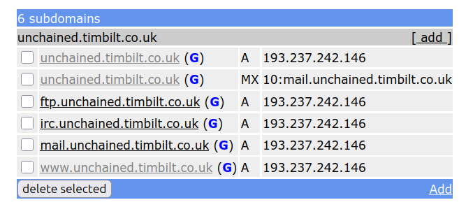

However if I go to unchained.timbilt.co.uk I just get a FreeDNS holder page. It looks in FreeDNS that this is set correctly:
However also if I enter the IP address it should be forwarding to I just get the login page for my router, not my Nextcloud instance. I’ve attached the output of ncp-report below:

Ah, this actually seems to have just started working! It must just take longer than I realised for this to work through.
Also take care, that your public domain is added to trusted domains in your config.php.
Thank you, yes, unchained.timbilt.co.uk was already added to config.php (presumably one of the steps in the setup wizard).
It was working, after a few hours the 401 error vanished and I could access it externally. It worked for about a week, but now it’s randomly stopped working, I’m getting the same error again:
“401 Authorization Required
nginx”

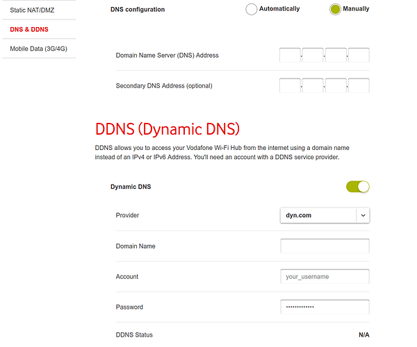

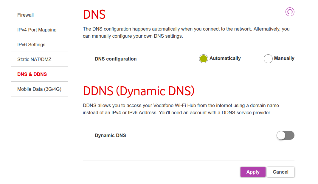

I haven’t changed anything, FreeDNS still says “Health: Active”, why has this just stopped working? :frowning: I’ve reboot the Raspberry Pi, no change.

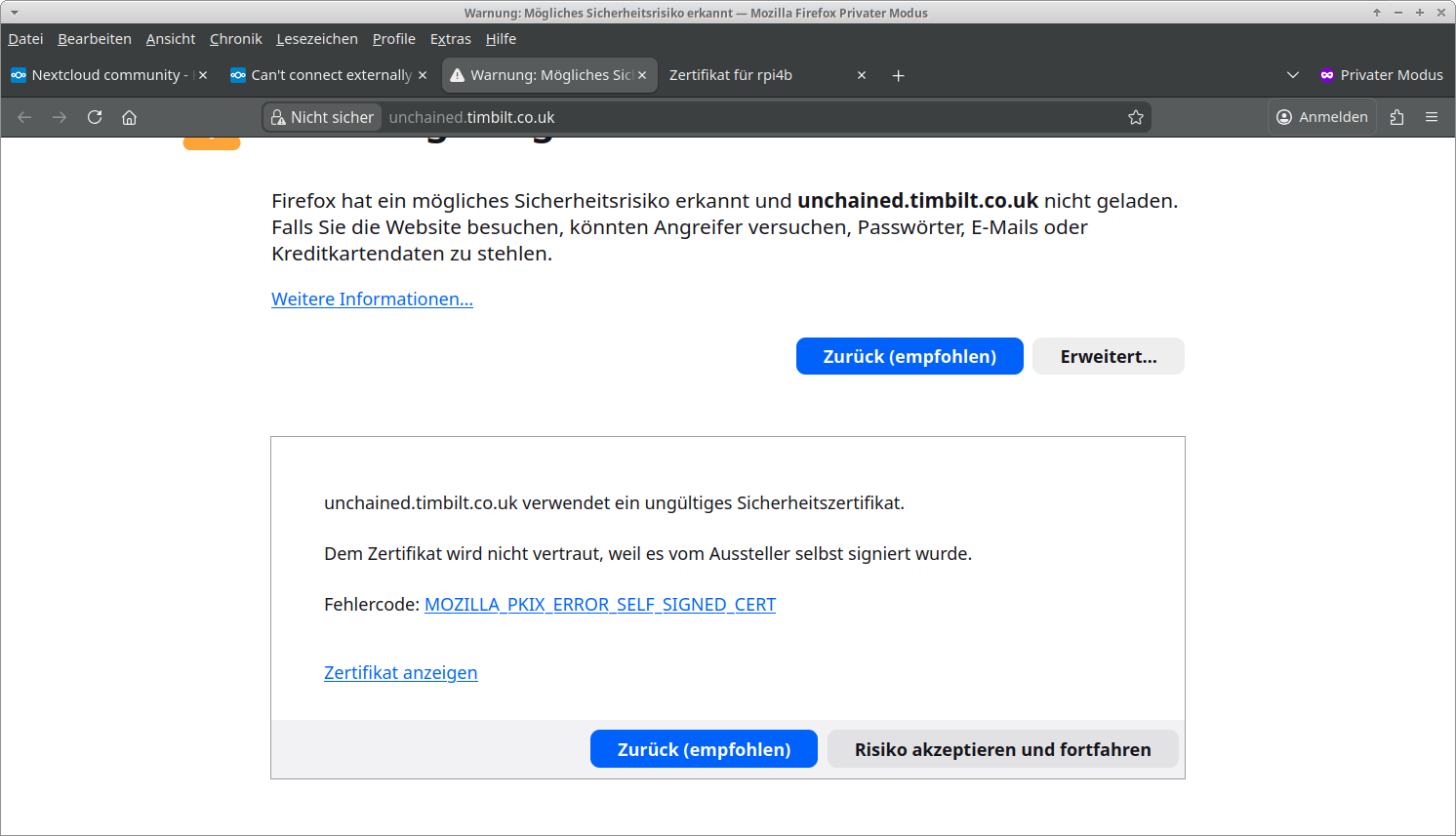

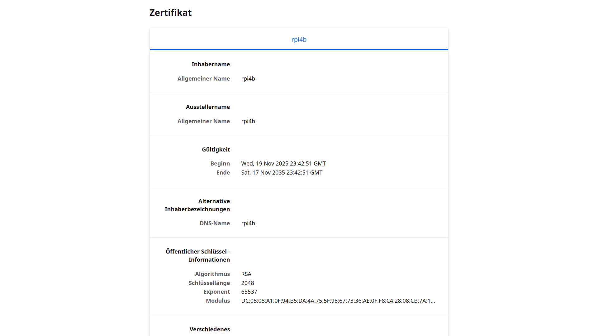

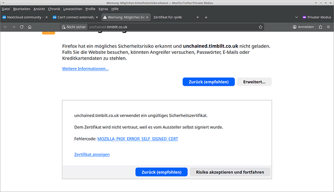

is working. But you are using a self-signed certificate.
It is not recommended to do so if you want to grant access to your NC-Server from www. Got a lets’s Encrypt Certificate instead.

You’re right, I’m not particularly experienced, but am trying to learn. I’m not actually intending to use this instance “for real”, I’m just seeking to try it out and see what it’s like, most likely I’ll wipe everything and start from scratch if it looks like I’ll be able to use it, this is really just a scratchpad for me to learn what I’m doing, hence not being too fussed about sharing details here, it’s not a domain I’m actually using for anything.

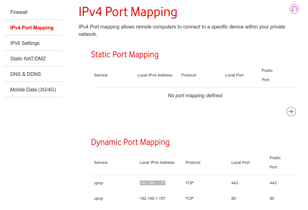

When it was working for me, I was accessing it away from where the RPi is located, when it was not working was when I was accessing the internet through the same router as the RPi is plugged into. I had interpreted this as stopping and starting working, but if you say it is working right now, I’m still getting the 401 error if I go there, so actually it seems I can’t access through the domain name if I’m using a computer that’s on the same internet connection as the RPi. Which seems odd. (obviously I can access it directly across the local network so it’s not exactly a problem as such, but is that normal behaviour?).
Letsencrypt was going to be my next question! Yes, I haven’t managed to get that set up, I have tried. I had assumed the reason it wasn’t working was the same root cause as the 401 error so I was trying to fix that first, but maybe it’s not. The log file from trying to run the letsencrypt set up is here

Thats called DNS rebind protection. Default active on many custumer Routers. You need to get an exception for your RPI4 Domain for DNS rebind protection. Not sure that is possible with your router.
Thanks, I’ll look into that. Is that likely to be anything to do with why the letsencrypt setup isn’t working
I can’t find any settings for this in my router setup, so it doesn’t look like I can turn it off. Could this be what’s not letting set up Letsencrypt?
Possible solutions:
  • get another Router, if your ISP allows that
  • setup your own DNS-Server and switch off the build in DNS of your current Router
Do you think this is the cause of my problem with getting the letsencrypt certicate?
I don’t know NC for Raspberry Pi. But with Nextcloud AIO the DNS rebind protection ist a problem creating letsencrypt certicates. And the proposed soilution for AIO is what i proposed above too.
Another thing you can try doing (which I did on my ISP-provided router) is set up a custom DNS entry in the router for your nextcloud domain.
So for example, in my router, I have an entry saying nc.mydomain.net is 192.168.1.xxx . Then when I am connected to my home wifi, my devices can follow the router’s DNS to the local IP address, and DNS Rebind Protection doesn’t kick in.
The only catch is for webbrowsers like Firefox, you have to make an exception in the DNS over HTTPS settings to allow firefox to use your router’s DNS for this website.
This probably introduces the smallest of security vulnerabilities to a MITM attack, which most likely will never affect you, but good to know anyway.
Dear @treesMcGees that may help if you already have letsencrypt certicates. But in my opinion not for creating them.

Unfortunately this doesn’t work, same “401 Authorization Required nginx” error if I go to my domain name on the local network and letsencrypt still fails. Just to be clear, in your description, 192.168.yyy.xxx is the IP address of my RPi on the local network and nextcloud.trilbytims.dydns.net is the address I type into my browser on the open internet, yes? (I don’t have to add an extra.dydns in there?)
The only DNS options I have on my router are shown here, there’s nothing here that’s useful is there? (these are normally set to “Automatically” and DDNS is off, I’m just showing the available options here).
192.168.yyy.xxx is the IP address of your RPi and nextcloud.trilbytims.dydns.net is thy DynDNS of your Nextcloud Server (so also RPI).
However, in my opinion, the screenshot you sent today contains at least two configuration errors.
  1. you maked DNS-Config as Manually. But at same time the DNS-Address and the Secondary DNS-Address felds are empty. That can’t work
  2. your DDNS-Status is N/A. But it shall be success, OK or however your Router will name a successful DDNS-Update
So i don’t know what Router you are using but with that setting nothing shall work as you expect it to work.
No, as I said, those options are normally set to DNS: “Automatically” and Dynamic DNS to “Off”, I had just selected those options for making the screenshot to show fully what was available to be set (although I don’t believe these are any help). They were set to “Automatically” and “Off” when I was trying with the modified /etc/hosts file. Like this:
I see. But how do you update the IP address after a (possible) forced disconnection or reconnection? Do you have a static IP address?
I’m using FreeDNS’s DDNS service to direct my domain name to my IP address for the Nextcloud usage. I’ve not touched the DDNS settings on the router, as I understand they’re only if I want to connect to the router set up remotely to the local network (and I don’t!).
This is a wrong opinion.
DynDNS on the router also should be configured for accessing a web-server in your network through port-forwarding. So FreeDNS is not needed.
