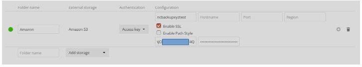

  • Configured External Storage with the values above: No connection
  • Configured External Storage with these values (bucket “ncbackupxyztest” which does not exist on Amazon S3 Drive) it works.

you must not create a bucket before. Choose a Bucket name which does not exist in you Amazon account. Nexcloud will create the bucket for you…
