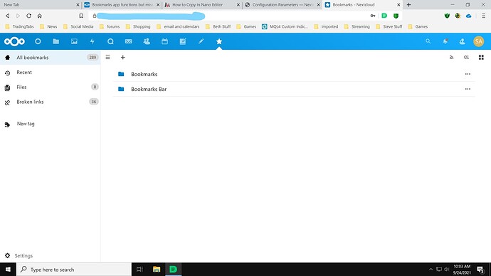

Hi, I have recently installed Nextcloud with bookmarks app and floccuss browser extension.
Fluccus does sync but it creates extra folders and also missing some items on other browsers.
Why is there Bookmarks and Bookmark Bar and seems like almost a duplicate
See image
All computers are using the same nextcloud account to sync with floccus.

floccus doesn’t do magic, but can only sync the folder structure that exists in the particular browser it is installed in. I suggest you have a look at the bookmarks structure in all your browsers. Some may have a bookmarks bar folder, others may not or have different folders. By default, floccus syncs the root folder, but you can also select specific folders to be synced. I suggest to select in each browser, a folder to match what you selected in other browsers.
These are likely browser-specific links like chrome://. The bookmarks app currently only supports http(s) and ftp links.

I check the bookmarks folder from within the browser and it looks like this.
I have no idea what is a typical sync on nextcloud should look like by default.
Should I even have anything called Bookmarks Bar ?
I don’t know where these 2 different sets are coming from. All 3 computers have the same structure that looks like this.
Screenshot (112)
With this structure you shouldn’t have a Bookmarks Bar folder, I think. Which browsers do you sync to?

Please be aware that, if you have a browser that has built-in folders like bookmarks bar, other bookmarks etc. (like, e.g. Chromium, Firefox) You may have to select one of those instead of the root folder to sync your brave bookmarks with that browser, because adding entries to the root folder is not allowed in those browsers.
Interesting, I’ll have to check this and that might be the problem, thanks.
When setting up floccus, it shows local folder as /
Then if I change it the main directory says “unknown”
Under this is Bookmarks. If I select Bookmarks then sync fails.
I did noticed that nextcloud shows a folder in the folder section called Bookmarks. I did not notice this before.
I removed it and also the folder called Bookmarks in the Bookmarks app.
This leaves me with ONLY a folder called Bookmarks Bar.
Now in the android app a folder appears called Bookmarks that is not in the Bookmarks app but only in the folders section.
This is sort of weird because I don’t know how Bookmarks Folder arrived in the folders section or in the Bookmarks apps.
It’s starting to look like the browser is using Bookmarks Bar as default folder but there is no such Bookmarks Bar folder in the browser anywhere that I can tell.
It’s very confusing.
Here is what floccus looks like
Screenshot (116)
and this
