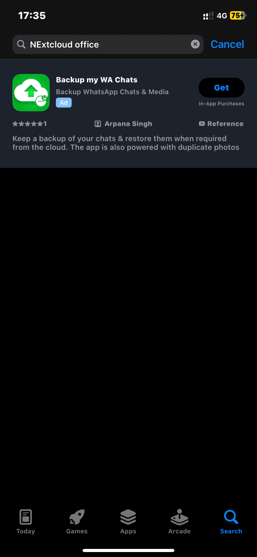

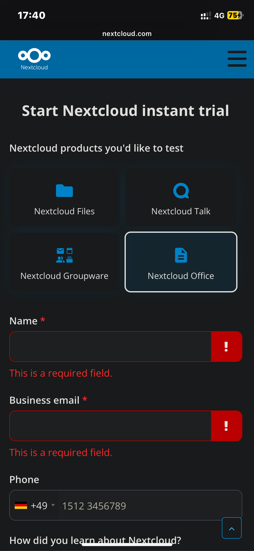

Does someone have a link please, as I don’t find NExtcloud office on the App Store and the NextCloud website appears to offer business products? I’m just a broke ass working class fool with little funds, coming from “free” Google drive.
You can test the demo server from Wolkesicher with Nextcloud Office included. Also you can register a free account at https://cloud.tab.digital with Nextcloud Office.
In you first screenshot is a wrong link. Use the link Sign up for a free Nextcloud account . There you can get a free account at https://cloud.tab.digital. Also you can get directly to https://cloud.tab.digital and get 8 GB for free.

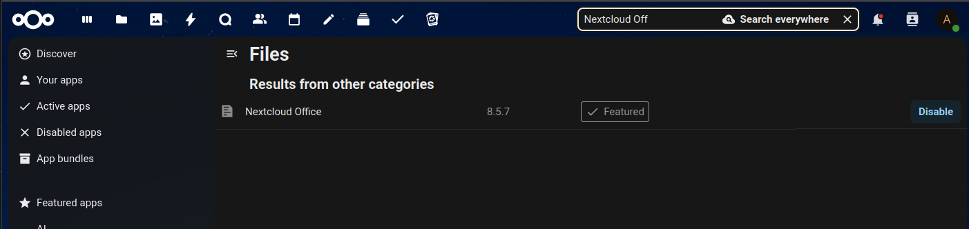

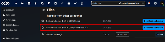

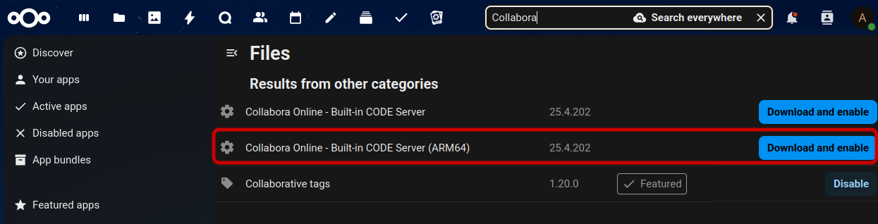

You need to install the following apps:
…and the actual document server for arm64, if your using an ARM Compute Instance:
…or the x64 one if you’re using an AMD Compute Instance:

Ok. 4 cores and 24GB od RAM should be more than enough fpr Nextcloud Office. So, just try to install richdocuments and richdocumentscode_arm64 via the apps section in your admin account.
In the Nextcloud App Store (Web GUI) they are named Nextcloud Office and Collabora Online - Built-in CODE Server (ARM64). You can find them installed in the Demo from Wolkesicher see infos above. However, you can also run Nextcloud Office (Collabora Online) on a separate server. In the Nextcloud GUI Administration you can find the settings for Nextcloud Office and Built-in CODE Server.

Nextcloud Office uses Collabora, so you need to install both.
The Nextcloud Office app is just a front end that integrates the Collabora server back end (the built-in CODE server) into Nextcloud.

Desktop → Browser → Nextcloud → Apps → Office & text → Collabora Online - Built-in CODE Server (ARM 64) is enabled.

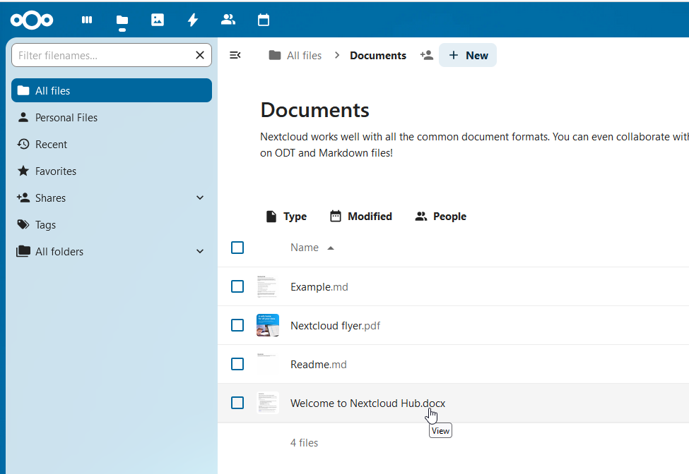

I can open Desktop → Browser → Nextcloud → Files → Documents → Example.md and edit, however Welcome to Nextcloud Hub.docx shows error: Document loading failed. Failed to load Nextcloud Office - please try again later.
