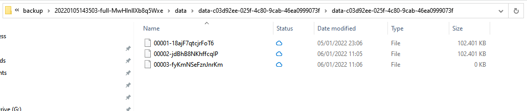

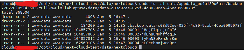

The backup is also not transferred to the external storage. I see a folder with the backup name on the external storage, thgis folder has many subfolders in it. But all of them empty.
