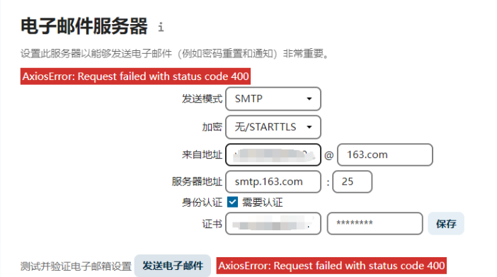

Hello, I encountered the same issue as you when using the same deployment version and environment, but even editing the configuration file cannot solve the problem. Can you give me some advice?
My conf configuration is as follows:
            "10.1.1.2:11224"
        "dbtype": "mysql",
        "version": "30.0.6.2",
        "overwrite.cli.url": "https:\/\/10.1.1.2:11224",
        "dbport": "",
        "mysql.utf8mb4": true,
        "redis": {
            "port": 6379,
        "theme": "",
        "loglevel": 2,
        "appstoreenabled": true,
        "default_phone_region": "CN",
        "default_language": "zh_CN",
        "default_locale": "zh",
        "enable_previews": true,
        "enabledPreviewProviders": {
            "19": "OC\\Preview\\TXT",
            "1": "OC\\Preview\\MarkDown",
            "2": "OC\\Preview\\OpenDocument",
            "3": "OC\\Preview\\PDF",
            "4": "OC\\Preview\\MSOffice2003",
            "5": "OC\\Preview\\MSOfficeDoc",
            "6": "OC\\Preview\\PDF",
            "7": "OC\\Preview\\Image",
            "8": "OC\\Preview\\Photoshop",
            "9": "OC\\Preview\\TIFF",
            "10": "OC\\Preview\\SVG",
            "11": "OC\\Preview\\Font",
            "12": "OC\\Preview\\MP3",
            "13": "OC\\Preview\\Movie",
            "14": "OC\\Preview\\MKV",
            "15": "OC\\Preview\\MP4",
            "16": "OC\\Preview\\AVI",
            "17": "OC\\Preview\\EMF",
            "18": "OC\\Preview\\Krita",
            "20": "OC\\Preview\\WEBP"
        "preview_format": "webp",
        "app_install_overwrite": [
            "files_markdown"
        "twofactor_enforced": "true",
        "twofactor_enforced_groups": [],
        "mail_smtpmode": "smtp",
        "mail_sendmailmode": "smtp",
        "mail_smtpport": "25",
        "mail_smtpauth": 1,
        "mail_smtptimeout": 30,
        "mail_smtppassword": "***REMOVED SENSITIVE VALUE***"
It should be noted that my Mariadb version is not recommended for V30.0.6. Is this related to it?
