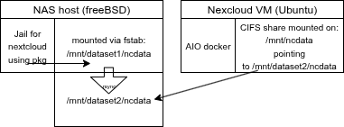

Edit: perhaps helpful. This is what it looks like:
So the question is still can I rsync or similar between the two locations on the NAS for the new AIO to use? Otherwise to do the “docker cp…” way, would mean both paths will need to be locally-resolvable. They are not currently both, only the “new one”.
