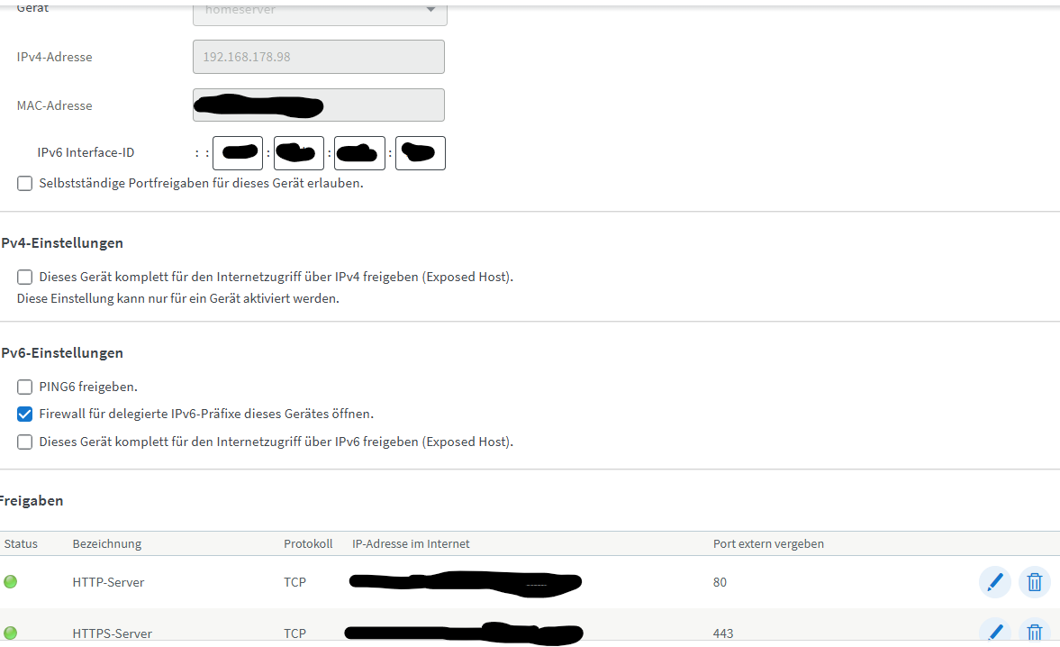

@saettel.beifuss0 This is how my port forwarding is configured:
double check if rebind_protection prevents internal access - if this is the case external access should work if port forwarding is setup right. I have no reference for ipv6 only setup… but for dual-stack port forwarding dialog looks different explicitly showing which protocol is used for specific share (maybe this separation doesn’t exist when only one protocol is active), similar to here:
review topics tagged fritzbox and ipv6 maybe you find useful hints

Your Firewall config looks ok.
Maybe check the IPv6 Interface-ID.
I am assuming that Raspberry uses the same network logic as Ubuntu (not sure if that is true).
So there should be 3 IPv6.
First one is a privacy extension enabled IPv6 that is NOT static.
Second one should be static.
Third one should be a link local, which we can not use outside our home network.
Check that your second IPv6 is what you get from mxtoolbox.com and what you have in your Fritzbox firewall rule.
Ok that helped a bit.
The wlan0 showed another Ipv6 compared to the No-Ip settings. After changing the IP at No-Ip I receive the message when opening the webiste “This is not a secure connection”, so one step further.
But in the FritzBox settings the IPv6 Interface ID is different, it is similiar to the second obal> value. Do I have change to something in the FritzBox?

My guess would be that you reached the webserver locally but not from remote, since you have the wrong IPv6 on Fritzbox.
