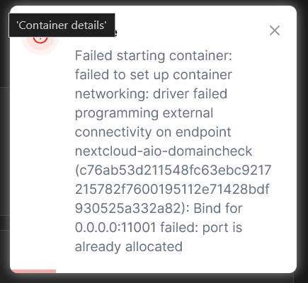

I am having the same issue. I have a fully functional Nextcloud AOI install with all of the same issues. I installed a Portainer agent on the server running Nextcloud. I can see 14 containers . All are running except the [nextcloud-aio-domaincheck]…
When I try to run the stopped container, I get this error…
I have the Apache2 port set as 11001. Not sure why there is a conflict.
I am running a nginx reverse proxy (NPM) on another local server.
Any ideas? Thanks
