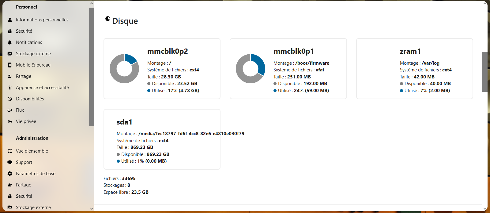

    • When trying to add SSD USB Ext4 as internal storage
    • NextCloudPi
[ I have a NCP self-hosted on a Raspberry Pi 4 on a 32Gb micro SD card because I want the system on the micro sd card to be separated of my files who will be on my USB SSD disk.]
  1. I format an empty SSD USB in ext4 using Gparted with my Ubuntu v24 laptop.
  2. I plugged it in my USB 3.0 port of my Raspberry Pi 4
  3. Then I enable the app/use this tool : External storage support
  4. I can see the NCP found it but cannot use it (see screenshots)
  5. I also tried using BTRFS File System but came to the same conclusion.
[files_external] Erreur: Local storage path does not exist "	/media/fec18797-fd6f-4cc8-82e6-e4810e030f79/"

Actually the problem is that I disable the “Control Center” (I don’t know how you call it) at the port :4443 and now is no more reachable.
Because I found a this document on how to enable SSH for NCP but you need the Control Center.
Can you tell me if this is possible to enable it back and how to do it please?
