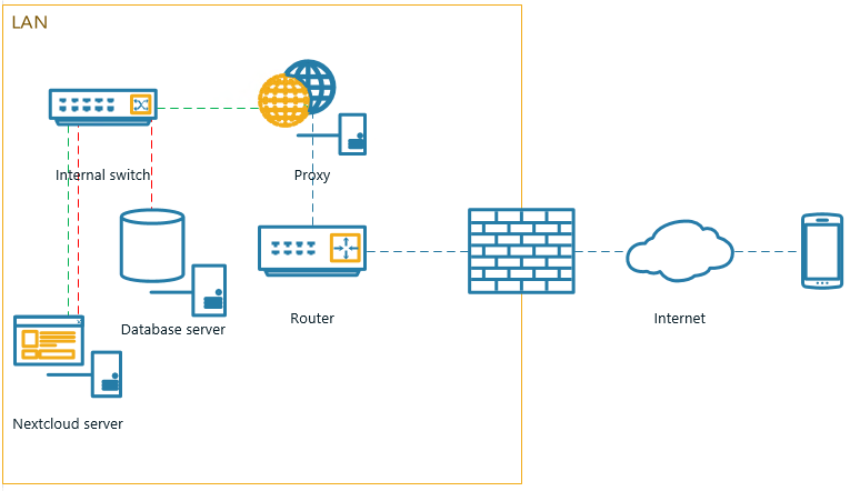

Here’s what the mobile clients appear to be doing:

I’ve had htop running on all nodes in the chain (proxy, webserver, database server) - nothing, absolutely nothing is reporting anything of significance there. Loads are minuscule and the apache/mysql processes barely register 5% on the host while logging in.

There is no real brute force app, but it is baked into the servers core components. The brute force list is valid for 24h if I remind this correctly (cc @lukasreschke). As you use a proxy it’s very likely that you don’t have it setup correctly. The X-Forward-For HTTP header needs to be set so that the Nextcloud instance sees the correct IP address of the different users and not only the one of the proxy. If this is not the case all users will get a penalty once a single user used a wrong password, because only the proxy IP is seen by the nextcloud and everybody has the same IP.
That’s exactly as I have proxying set up at home because a) it requires no additional config and b) I’m the only user :slight_smile:
