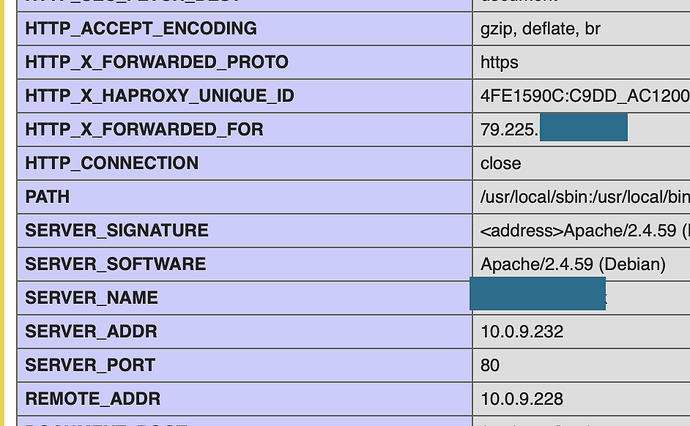

Are you sure that your proxy is sending the HTTP_X_FORWARDED_FOR? You can test this, for example, by placing a PHP script within the Nextcloud installation that dumps the headers.

@mritzmann I hacked the .htaccess to allow a test file to show phpinfo() in the running instance and I can confirm that the HTTP_X_FORWARDED_FOR is set correctly. Below you can see the internal Docker Swarm IP of the load balancer (reverse proxy), the internal address of the NextCloud instance and the external IP of my router at home:
