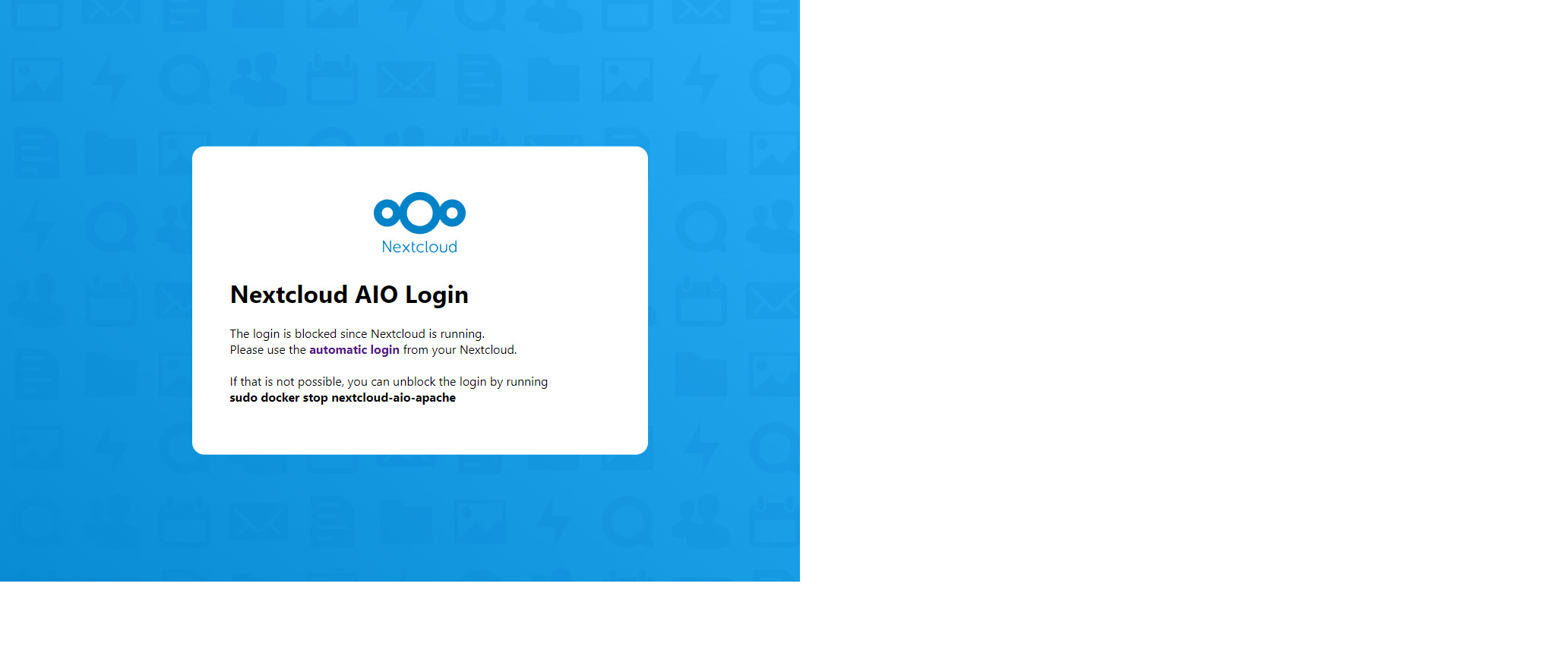

On Https://localhost:8080 I get
The login is blocked since Nextcloud is running.
Please use the automatic login from your Nextcloud.
If that is not possible, you can unblock the login by running
sudo docker stop nextcloud-aio-apache
And I got confused. I am not sure what to do next and I don’t want to make it worse.
Please do as advised

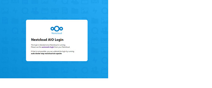

I tried clicking on automatic login and got the git.
Tried to enter https://xxxx.duckdns.org/settings/admin/overview
and got the site can’t be reached
Any pointers?
Run docker stop nextcloud-aio-apache and then reload the page on port 8080 and log in. Then you should stop and start the containers again and it should show the initial credentials to you after all container are running.

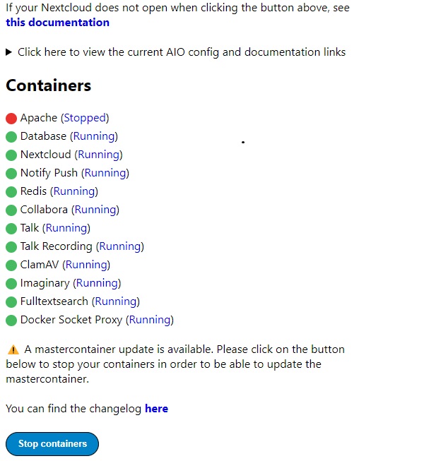

I did. this is what I got
Yes this looks good. Now do the next steps that I mentioned.
Click on stop containers and afterwarss start container. After all are up again you should see the credentials.
I am doing the update. looks like it is taking a while

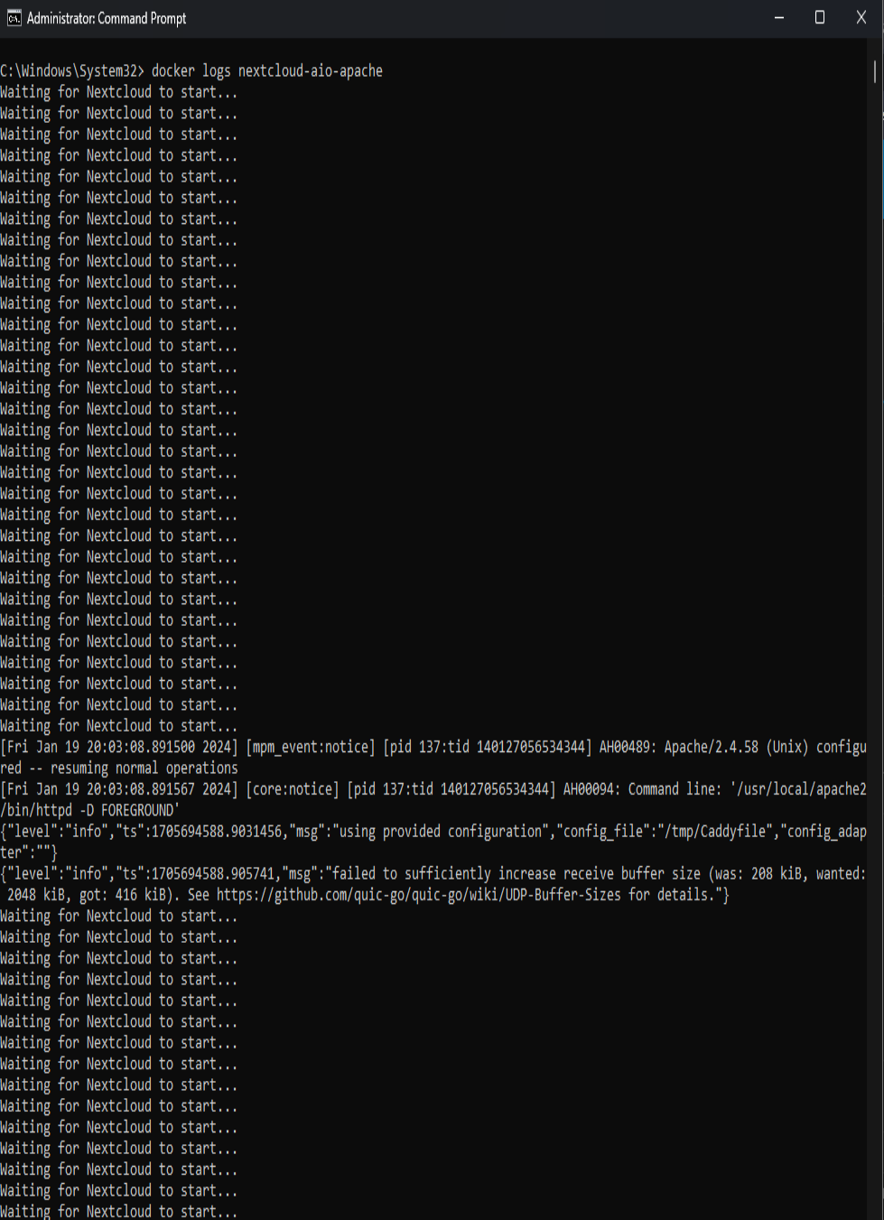

Now, can you post the output of docker logs nextcloud-aio-apache here?
Can you scroll down and post the most recent logs here?
