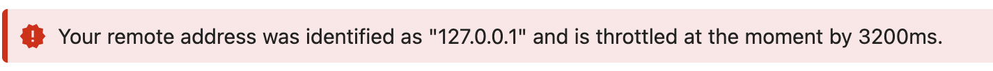

Why is my remote IP `127.0.0.1`?
    • 31.0.5
    • Debian 12
    • Apache/2.4.63
    • replace me
    • 8.3.21
    • Yes
    • After configuring trusted_proxies with my reverse proxy’s IP
    • Nextcloud AIO 11.0
/settings/admin/security and that logs are showing my remote IP as 127.0.0.1 leading to some throttling.
Before it showed the Tailnet IP of my reverse proxy, so I configured trusted_proxies 2 to include that IP per ip.address.that.is.shown in the all-in-one issue#2045:
asavage@ifrit:~/docker/nextcloud$ sudo docker exec --user www-data -it nextcloud-aio-nextcloud php occ config:system:get trusted_proxies
127.0.0.1
::1
172.19.0.0/16
100.125.169.125
I have a Caddy reverse proxy on a separate server:
https://nc.redacteddomain.me:443 {
	reverse_proxy 100.113.236.81:11000
IPV6 is disabled everywhere.
I don’t think Caddy is misconfigured because my Jellyfin server uses the same reverse proxy and detects the client IP correctly.
Is there something to configure in Apache to debug this further? I can’t edit the config file there because it’s on a read-only filesystem in Nextcloud AIO
Example log entry showing the wrong remote IP
https://gist.github.com/asavageiv/fa098449285ebb07cf99ebc5f13458ff
Reverse proxy detects the remote_ip correctly:
docker log nextcloud-aio-apache:
I’m not sure how to get the access logs of the AIO Apache with headers. If anyone knows that would help debug things.
Caddy 2.6.2
Sorry I can’t edit the post. I get an error saying new users can’t post more than 4 links.
I used tcpdump to inspect the traffic on the nextcloud-aio network.
I see requests going from my reverse proxy to the http server with this:
X-Forwarded-For: 98.97.25.71
X-Forwarded-Host: nc.redacteddomain.me
X-Forwarded-Proto: https
So it looks like the headers are correctly being set because 98.97.25.71 was my correct IP at the time.
Just tried a fully clean install and I get the same behavior.

I think I figured out the problem. Nextcloud AIO has its own Caddy in the nextcloud-aio-apache container that acts as a reverse proxy to all the Nextcloud servers within the docker network. That Caddy has its trusted_proxies configured independently from the Nextcloud configuration in all-in-one/Containers/apache/start.sh
I was able to use the shell in nextcloud-aio-apache to modify the Caddyfile to include my reverse proxy’s internal IP, reload that config, and see that the problem goes away.
I think that when the reverse proxy is running on a different server, we need a way to configure trusted_proxies for both Nextcloud server and the nextcloud-aio-apache Caddy instance. Alternatively, I can insert another reverse proxy into the same docker network that trusts my reverse proxy’s IP into the chain, but I don’t like that solution much.
