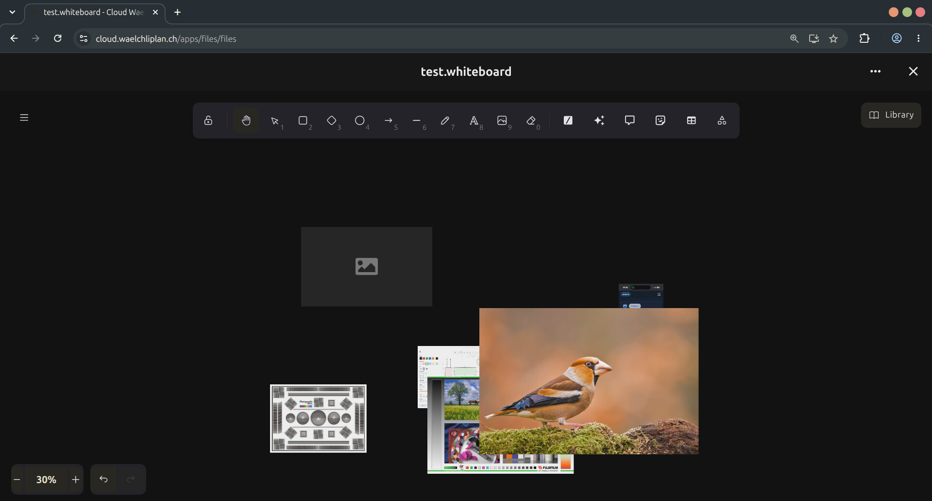

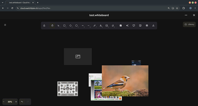

When using a whiteboard some pictures do not load, there is a placeholder shown instead. This happens with images uploaded from a device and pictures copied from google, WhatsApp. etc. The size of the images don’t seem to have an affect on this. I have replicated this issue on two separate and independent Nextcloud-AIO instances. (Each instance has been setup by different people, making misconfiguration seem unlikely.)
Steps to replicate it :
Create a whiteboard
Open the whiteboard with two different accounts. (Or create a public share-link for the whiteboard and open it with another browser / private window)
Start pasting pictures into the whiteboards using both the different accounts. Keep dev-tools open in one browser-window, you should start seeing errors.
nextcloud.log
no logs relevant logs from nextcloud.log while reproducing the issue
logger.ts:41 [Sync] Local sync failed: DataCloneError: Failed to execute 'postMessage' on 'Worker': async(e,t,n,a)=>{let i;try{i=await uN()}catch(r){return r.name==="AbortError"||r.name==="NotAllowedError"?!1:(c...<omitted>...}} could not be cloned.
