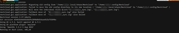

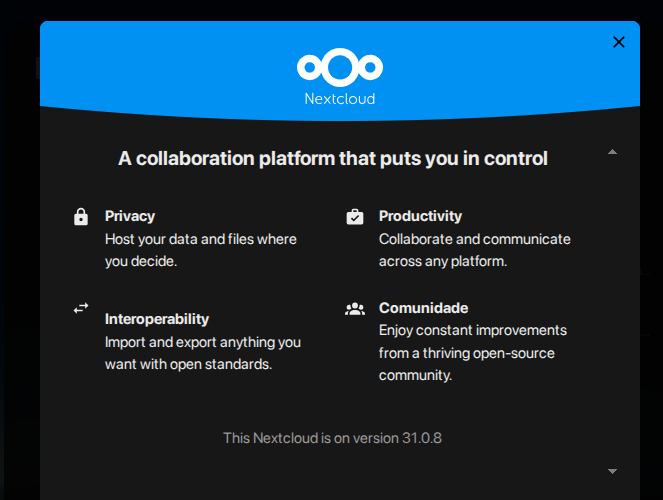

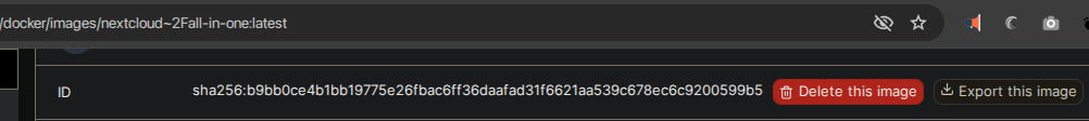

I think I am using the official one
Issuing pikaur nextcloud I get (among other things):
(Again) I think, the latest one:

Good that you confirmed you’re on the latest AIO and desktop client.

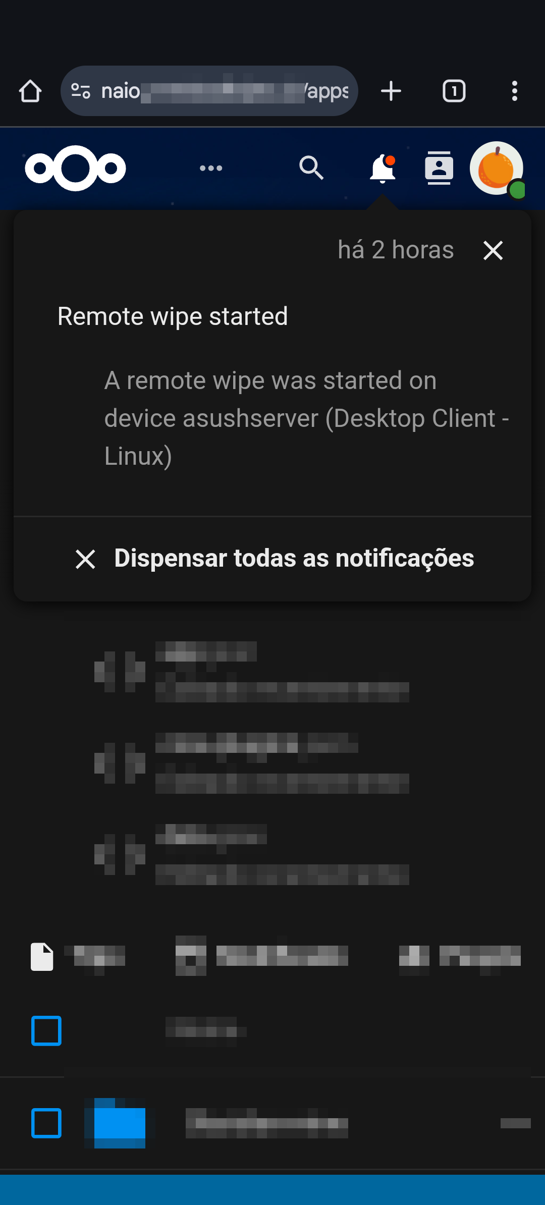

Hi, @jtr, thank you for your interest, and to you and everyone else, I apologize to not answering sooner.
Well
 direct answer (taken from my mobile phone web browser, approximately 2 hours after that remote wipe happened; the second screenshot was taken about twelve minutes after the first one):

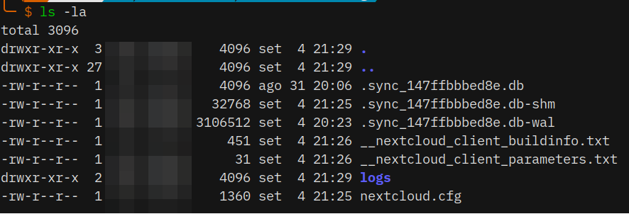

Ok. Please take a look at this:
In turn, yet, I am skeptical about the details one would obtain from these files, that are present in the debug log that we were looking for:
If you look closer the date of the .sync_147ffbbbed8e.db sqlite file is very close to when these latest oddities happened. Before looking for ways to grasp or poke into its contents (if there might be a way to have that insight into it), I ask you for a more expert advice: could there be any accidents by opening this sqlite file/db?

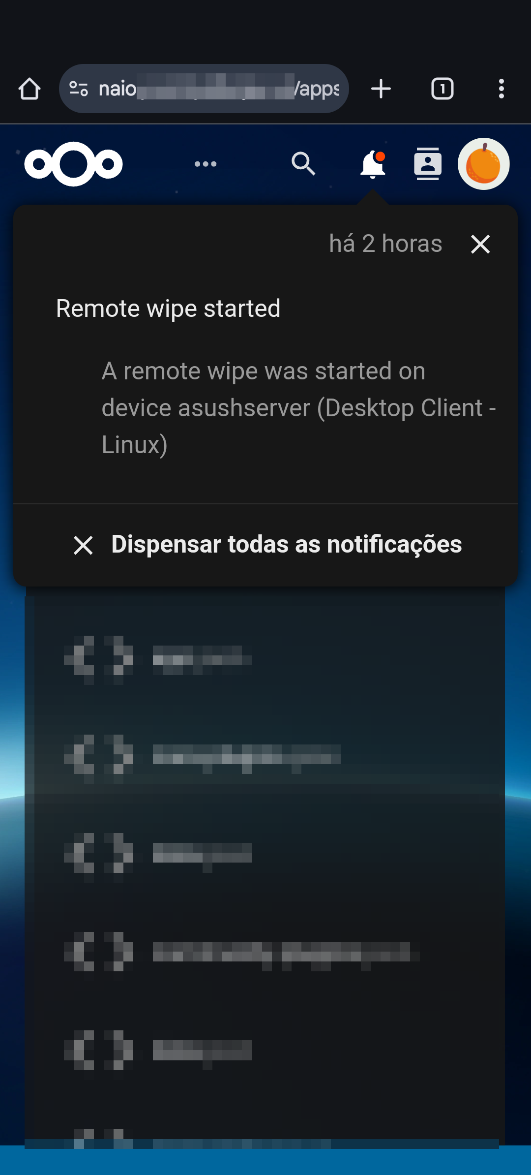

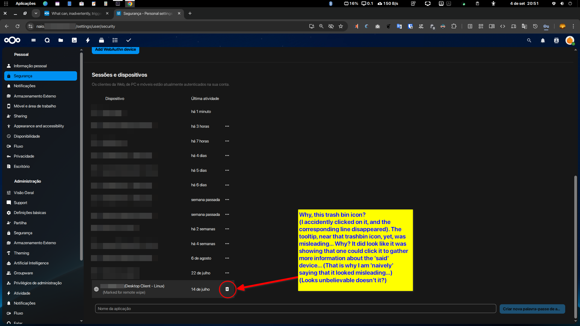

Okay, yeah that is definitely the Remote Wipe feature so it’s being triggered somewhere. This has nothing to do with syncing empty folders from a corrupt system or anything like that. So something is going on here, since a wipe has to be manually triggered.
The screenshot with the trash icon indicates the remote wipe has already been requested (but not yet completed).
The way to trigger a remote wipe is to select the 3-dot menu on a device/session (such as those ones above) and selecting Wipe device. Even then it’ll pop up a prompt that says Do you really want to wipe your data from this device?
The only other way (outside of the Web UI) to trigger a remote wipe I’m aware of is via the provisioning API (which would be something you might use if you had some custom account provisioning tools).
If neither of the above jog the memory of you or your admin about the origin of the Remote Wipe request, the only way to track down what’s going on is going to be to look at your server-side logs. I already gave some clues what to look for in just the web server logs: any transactions with wipe in the URL.

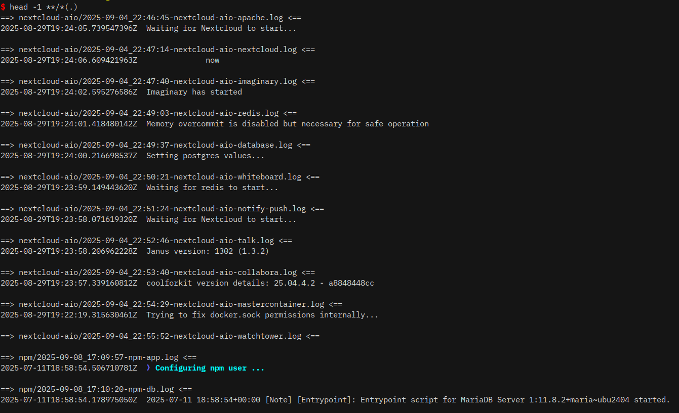

After you pointed that strategy for searching the logs for the wipe transaction that indeed lead me there.
Since all of the infrastructure for both the All-in-One Nextcloud and the (needed) proxy-manager (Nginx-Proxy-Manager, npm, for that matter), is running from docker containers, I tried to gather the docker logs as soon as possible.
After that, after having read your latest answer (the one that I quote above), I gathered the last logs from npm (both the app and its db) and searched therein (as well as in the other nextcloud-aio containers), for that wipe’string’.
This was the result:
The result was ‘null’
Also these are the longest the logs span
As you can see, maybe this will all be inconclusive. The fact is that the logs do not span that much time (with the exception of npm).
