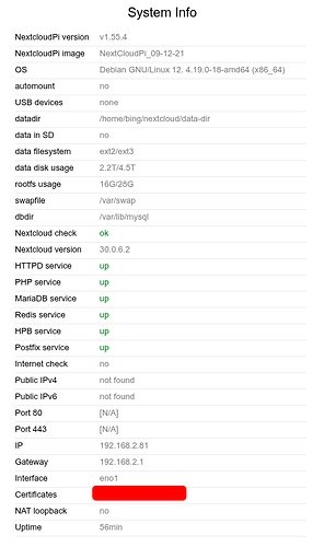

I use Davx5 on my android device. It is failing to connect to my server to sync, when on cell service or wifi away from home/server. When I get on my wifi at home, it syncs fine. Nextcloud app on my phone also fails to sync if not on home wifi. I’ve been using this system since 2021 (when last installed).
I use no-ip ddns, it is updating properly.
I noticed on my system info page of the ncp web panel, that for Port 80 and Port 443, it shows: [N/A]. My router still has the ports open. I tried rebooting the server and router with no success.
If i rerun the no-ip setup on the NCP web panel and click apply, it returns:
[ no-ip ] (Wed Sep 24 22:39:58 EDT 2025)
Auto configuration for Linux client of no-ip.com.
Can’t connect to dynupdate.no-ip.com (Connection refused)
Network must be operational to create configfile. Ending!
  1. on internet away from home, attempt to sync davx5 and it fails. Nextcloud app also fails
  2. reboot, same issue

So I’ve identified that this is a router or isp issue. My emby server is also inaccessible remotely and that’s just using the ip and port in a web browser.
This can be closed if necessary but I’d still appreciate any tips to resolve this. I’m going to factory reset my router. But first will connect my server machine straight to the modem to see if the issue persists. This will narrow it down to something on my server blocking ports or my isp.
It’s definitely something on my server machine or my isp. Directly plugging into my modem and then using my phone cell service to try to access nextcloud or emby fails.
It was my router. Reset it to factory defaults, reassigned my dhcp addresses and reserved them, opened ports and voila. I have remote access again.
