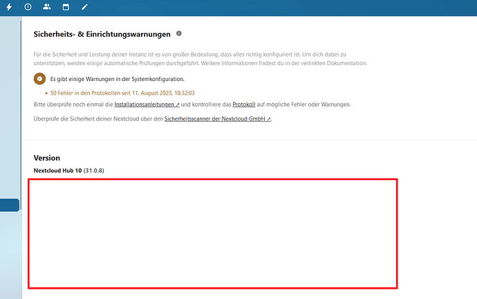

Web update option missing since NC 31.0.6
    • 31.0.8
    • Ubuntu 24.04 LTS
    • Apache 2.4.58
    • none
    • PHP 8.3
    • no. See below.
    • after updating to NC 31.0.6
    • bare metal
    • no
Since I used the web-UI update from 31.0.5 → 31.0.6, my update option is missing from the UI. See screenshot.
  1. nor sure. I did a switch from Owncloud->Nextcloud long ago, and updates/upgrades since NC 27.x or 28.x up to 31.0.5 without problem. After hitting 31.0.6 the update option is simply gone. Happened on two servers. (A third server was upgraded from 30.0.x directly to 31.0.7. Here the UI option is still there!)
  2. I can however upgrade via command line using sudo -E -u www-data php /var/www/html/owncloud/updater/updater.phar
    Thus I updated from 31.0.6->31.0.7 and from 31.0.7->31.0.8 without problems on both faulty servers. I had hopes the updates would mitigate the issue, but the missing info persists.
No specific log entries are created.
not browser-related. tested in various browsers with same results.
access.log does not contain anything out of the ordinary when I hit the “administration settings” → “overview” page

compared config.php from my broken and working NC systems. No differences there, except db-credentials and URL.
        "updatechecker": false,
            "131.130.59.17",
            "md-server.anthro.univie.ac.at"
        "overwrite.cli.url": "http:\/\/131.130.59.17\/owncloud",
        "dbtype": "mysql",
        "version": "31.0.8.1",
        "mysql.utf8mb4": true,
        "appstoreenabled": true,
        "apps_paths": [
                "path": "\/var\/www\/owncloud\/apps",
                "url": "\/apps",
                "writable": false
                "path": "\/var\/www\/owncloud\/apps-external",
                "url": "\/apps-external",
                "writable": true
        "theme": "",
        "loglevel": 2,
        "allow_user_to_change_mail_address": "",
        "encryption.legacy_format_support": false,
        "encryption.key_storage_migrated": false,
        "mail_smtpmode": "smtp",
        "mail_smtpsecure": "ssl",
        "mail_sendmailmode": "smtp",
        "mail_smtpport": "465",
        "mail_smtpauth": 1,
        "app_install_overwrite": [
            "files_texteditor"
        "maintenance": false
Same here: broken and working systems have roughly the same apps. The working system has even more apps installed…
I am pretty sure there is already a solution for this, but I simply can’t find it. Any help appreciated!
Hi @guilegatan
Try either removing that line from the config.php file or changing it to true.
Thank you bb77!!
Problem solved! So simple yet it eluded me…
