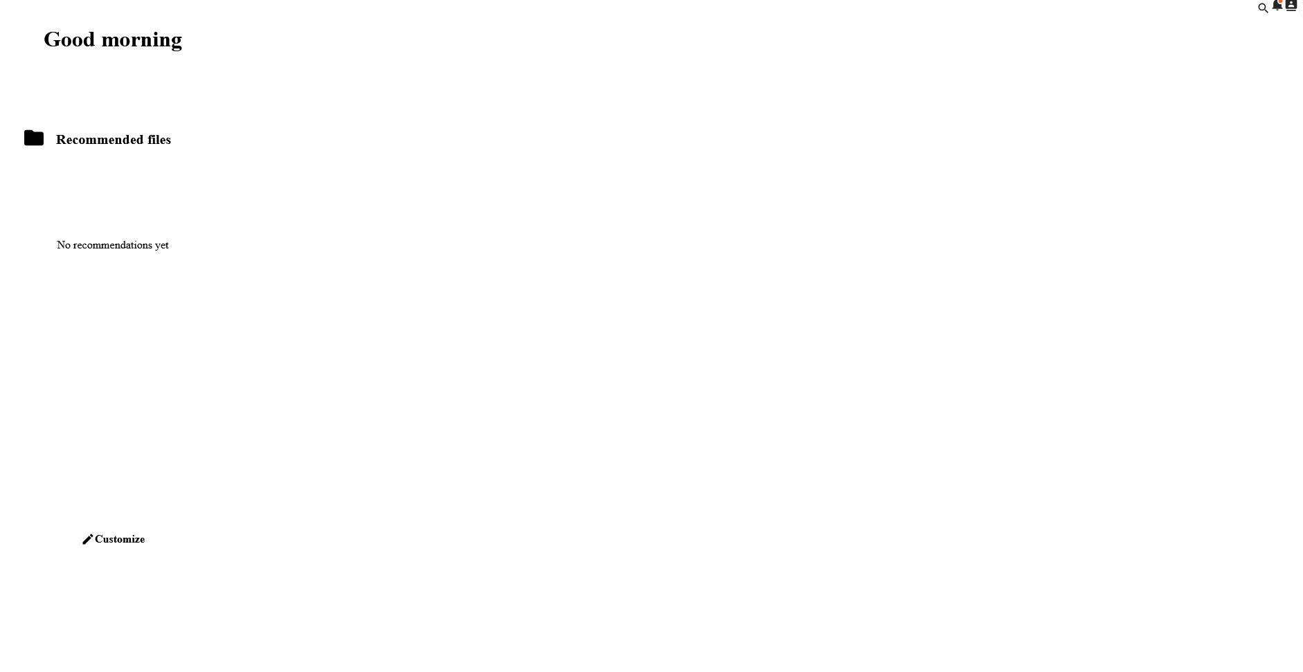

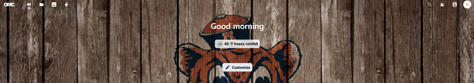

I am running into an issue where if I update from version 31 (Hub10) to version 32 (32.0.1 or 32.0.2) after the upgrade the web interface is completely messed up.
This is what is looks like on v31 after logging in:

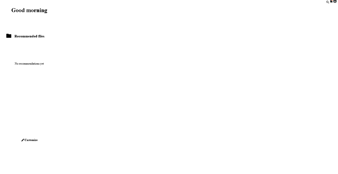

This is what is looks like on v32 after the upgrade:
Just wondering if this is an know issue (I didn’t see anything specific to it in my searches). I would like to upgrade to 32 to be on the latest, but not sure what is happening here.
  1. Upgrade from 31 to 32 with any method, I have tried Edge and Firefox as well in a private window.
You left out your config, apps, browser console output so we don’t have a lot to go on to help you. Also unclear whether you’re using a reverse proxy or not. If so and if happens to be NPM, disable asset caching.
I would start by checking the browser console output.
I have just experienced the same problem.
Error messages on clients talked about SSO. So I disabled app “SSO and SAML authentication”. After that no more problems.
When I tried to activate it again, Nextcloud prevented me, stating that it would cause instability.
This app was not for production yet on my side so no big issues here for me.
