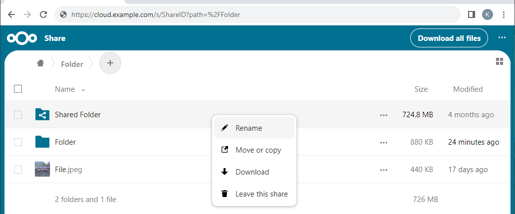

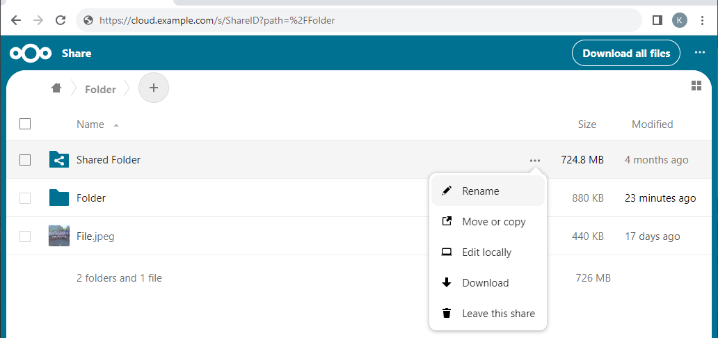

I want to edit the context menu, when clicking on the three dots and when right clicking on the folder or file. But only with a defined path, as an example “/s/ShareID?path=%2FFolder”.
“Rename”, “Move or copy”, “Edit locally” and “Leave this share” should be hidden. Visual only.
There are no special requirements that the mentioned functions are possibly executed via a bypass.
