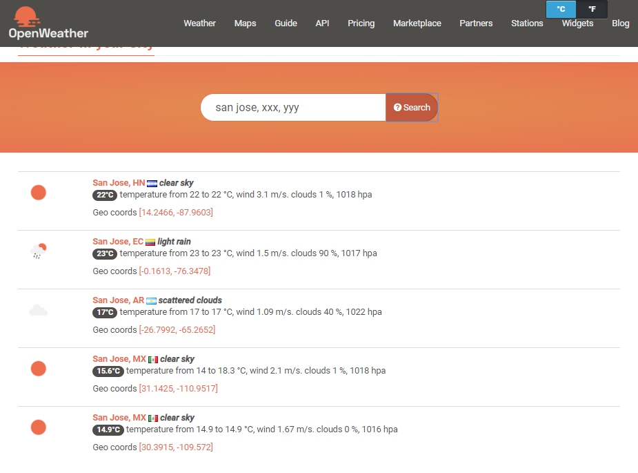

Based on that I would recommend to visit the Open Weather Map website, search for your site by entering more detailed information, like “San Jose Mexico”, identify the right data, take the geo cordinates and use it to configure the map.

For now, if you are unsure which is the right city, you can go to www.openweathermap.org (where the Weather app gets its data from) and search for the city you want to add. There are only 5 or so different locations named “San Jose” or “San Antonio” (mostly in different countries) that you can add using the country code. For your town Bayswater, there is only one result in the UK and one in Australia. Maybe you could try to add a city that is next to your town?

if you enter Bayswater, Western Australia, Australia, for some inexplicable reason you get a list of all the first five Bayswater cities worldwide.
Maybe not. I just tried with San Jose and got a list of five (out of 1,716 according to the OP)

That seems like a bug in the Openweathermap API/search, not much the Nextcloud app can do about until they fix up their search.
