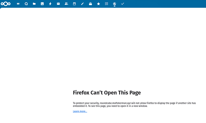

I have gone to:
Administration settings > External sites
Then typed in a name and a complete URL
(in this case “Roundcube” with URL https://roundcube.mofisherman.xyz
The icon for the added website then appears in the Nextcloud toolbar. However, when I try to open it, I get the following message:
Is there a way to add Roundcube so that it can be viewed inside Nextcloud (not in some separate tab, for instance)? I realize that Roundcube is trying to prevent XSS attacks, but I thought someone might know a way around this.

You’re right - this is due to Roundcube blocking embedding via X-Frame-Options or Content-Security-Policy. To view Roundcube inside Nextcloud (not a separate tab), you’d need to modify Roundcube’s config to allow framing from your Nextcloud domain. Look for X-Frame-Options in your web server or Roundcube headers and set it to ALLOW-FROM your-nextcloud-domain. Be cautious though - this weakens security and is not recommended for public-facing servers.
Yes, and since there is an app that implements this within the Nextcloud structure, the app is the better way to go.
