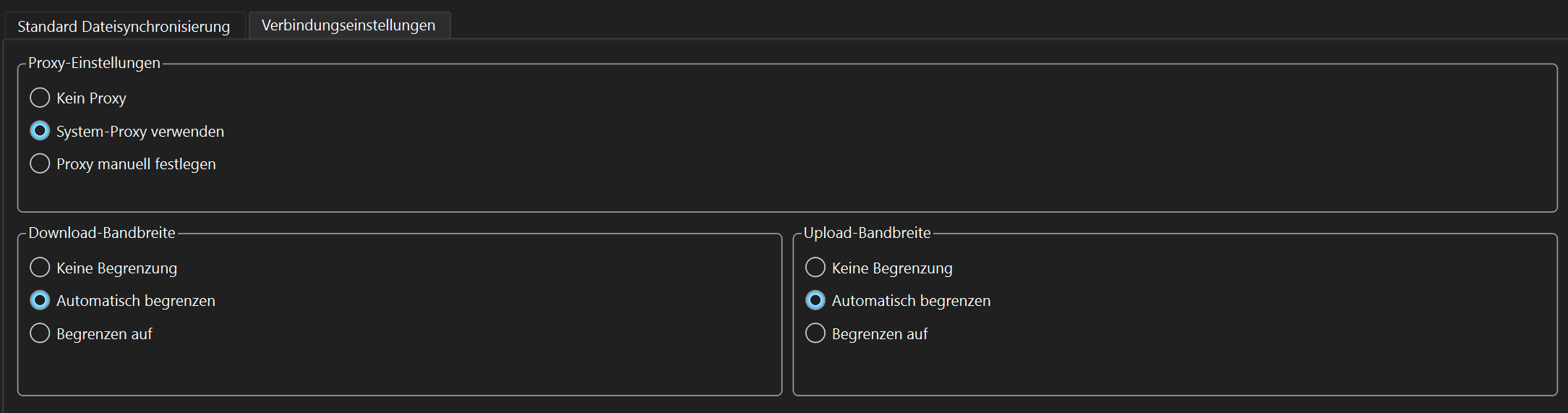

Oh wow. Noticed this accidentally: file sync is awfully slow. ChatGPT redirected me here and YES, this was my Windows desktop client’s setting with v3.17.2:
Of course I removed those automatic upload and download bandwith limitations instantly again! No idea when exactly they got introduced, some update must have messed those settings. Gosh, lost 1 hour with tests, checking every component on the server side…
Thank you. Omg, who created this? I thought there was some issue with the server performance and it was this damn feature. 3 hours for download 10 GB when there is 2.5 Gbit between me and the server, after turning it off was done in a minute.
