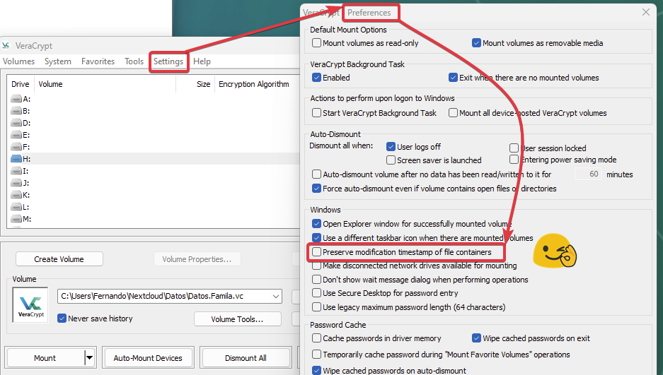

This is a huge issue for me - my veracrypt containers are not being detected as changed even as I change their contents. I suspect this has something to do with the fact that neither the file modification timestamp nor the file size changes as I modify their contents. Not being detected as changed means that it’s not being synced by the client, and won’t be accessible from elsewhere or from other clients.
System info:
Windows 10
Nextcloud Windows client v2.2.4 Build 2
A workaround: Use Windows’ ‘copy’ command to update the modified date on the files.
You can do this by making a batch file with
copy /b filename.hc +,,
Reference: https://superuser.com/questions/10426/windows-equivalent-of-the-linux-command-touch/764716
In TrueCrypt there was an option in the settings where you needed to uncheck:
Preserve modification timestamp of file containers

@pwkl999 Well, as you can see, Nextcloud does not yet have delta sync. For me though, I use fairly small size veracrypt containers (<500MB) and I’m often using them at home where Nextcloud can sync over LAN. Therefore, it delta sync doesn’t really matter for me. However, the tips above did solve the original problem of containers not syncing.

TrueCrypt is EOL. Therefore, one should not use it. Unfortunately, VeraCrypt as its successor does not offer such a setting.
