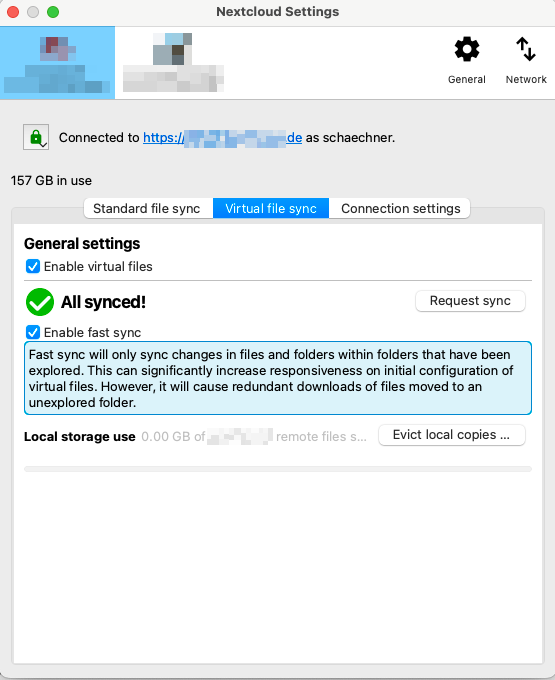

I would like to use the Nextcloud Desktop Client on MacOS with virtual files.
I have the latest MacOS, Nextcloud Client and Nextloud-Server Version.
I have downloaded the correct version but it still isn’t working.

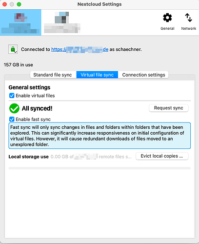

I think, I should have everything configured correctly:
The problem:

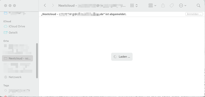

When I try to access the (virtual files) of Nextcloud in the Finder of MacOS, Nextcloud is supposedly logged off. When I tap the “Log in” button, everything hangs up and I have to restart the Finder manually.
You can see it below:
The synchronization I tried for “Standard file sync” worked.
I can’t imagine that the 200GB (without shared folders) is too much and will overload my Mac.
Does anyone have any idea what the problem might be? Everything else works perfectly, but I would be very happy about this little detail (it also works on Windows).

just signed up to comment as well. I have the exact same issue and do not know where it’s coming from. I’ve set up a second nextcloud instance and uploaded only a few files (35mb) and I have the same issue. So your storage size being 200gb cannot be the issue
