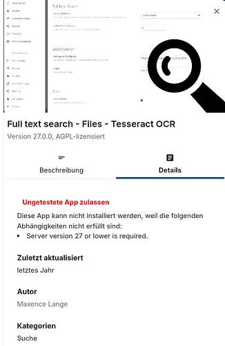

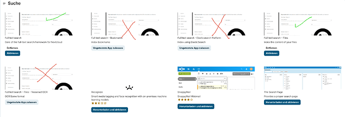

First i have “lost” my capability to scan my pdf files with tesseract. (stuck in < NC 27 !!!)
Now i have lost my fulltextsearch_elasticsearch app (stuck in < NC 29 !!)

Does it make sense to have the fulltext search (core) plus the fulltext search files app (these both are only compatible modules for nc30.x at the moment) without the other modules mentioned above (that are indeed not compatible for now)?
In the admin section the fulltextserach is still a part of but i can change there not much more than tagging the extra search button in the main menue. The drop down for search engine is “dead” because of the missing eleasticsearch connector!

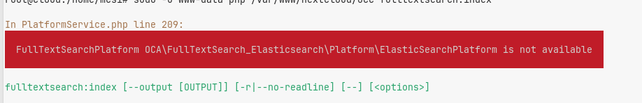

The nextcloud fulltextsearch_elasticsearch app is not compatible with Nextcloud 30.0.1. The full text search with ElasticSearch stop working and the WARN message in the logging,
“FullTextSearchPlatform OCA\FullTextSearch_Elasticsearch\Platform\ElasticSearchPlatform is not available”

For the moment i am searching for information if tesseract is maybe obsolete because one of the NC30 comaptible fulltextsearch modules can assume this “job” meanwhile??
