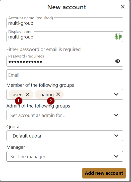

Just to be clear - you are trying to create a user who is member of multiple groups like this
if this is the case my user had both groups assigned at the end (NC 31.0.4)

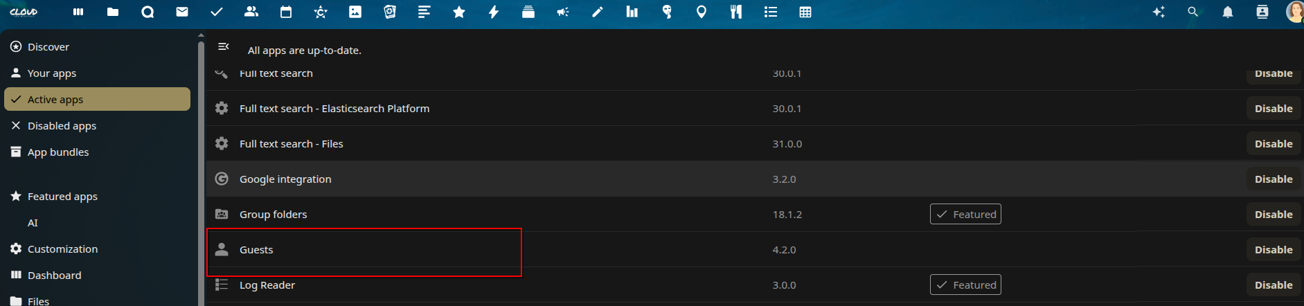

Adding more details for clarity.
Guest App version 4.2.0 is installed:
It seems that this app created the Guest group.
In this screenshot, a new user is being created. It’s also visible that the Guest group is empty, even though multiple Guest user accounts have been created:
The created users are, of course, assigned to the plex_media group in this case, but they are not added to the Guest group.
