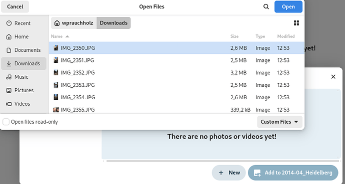

First way to upload was to create in Nextcloud app an Album in Photos and then upload all pictures. I am getting to the point as depicted underneath, when selecting a photo. Then nothing happens. Selected pictures do not get uploaded

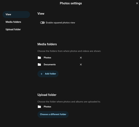

I would try the following steps…
Configure the Photos app and tell it which folders to display photos from and where the default upload location should be when uploading photos to an album.
In the above example the Photos app will show photos from the Documents and Photos folders and it will upload photos, that you directly upload to an album to the Photos folder. (Afaik, that won’t change the location of existing photos that are already in one of the defined Media Folders on your Nextcloud when you add them to an album.)
You cannot drag and drop photos directly into an album, but you can try one of the following methods instead:
Upload the photos via the Files app to one of your defined Media Folders, and then add them to an album manually in the Photos app…
Upload the photos from the “Folders” section in the side pane of the Photos app by clicking on the “+ New” button and then add them manually to an album
Upload the photos directly to an album by going into an existing album (can be an empty one) and clicking on “+ New” → “Upload Files” which will upload the photos to the “Upload Folder” defined in the screenshot above and add them to the respective album in one step.
