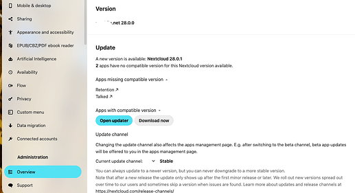

hi @Mageunic, many thanks for you ansmwer. I don’t see this option in the web UI in the Admin settings. Any idea how long I have to wait?
hi @owegen,
Please go to → Adminstration → Overview as Admin and you should see it.
Please also check Current update channel
https://docs.nextcloud.com/server/latest/admin_manual/configuration_server/config_sample_php_parameters.html#updater-release-channel
But it says that I already have the latest version installed:
Version is 27.1.5.
“The version is up to date”
Update channel is “stable”
Switch to Beta, reload the page and install the update. After that switch back to stable.
With the beta channel you can force it :slight_smile:
When I switch to Beta, it shows “Nextcloud 27.1.6 RC2” instead of Nextcloud 28. How do I get it to show Nextcloud 28?
