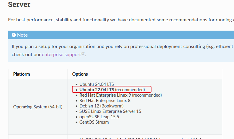

Also, tell me why the official Nexcloud documentation still recommends 22.04? :slight_smile:
Unfortunately, I don’t know that either. Perhaps a mistake. Maybe it’s also intentional, because similar to Nextcloud, Ubuntu doesn’t want you to switch on the day of release. A change period of one year is still normal for Ubuntu LTS, for example, and has not yet been reached.
In the end, it also makes a difference whether you run Nextcloud privately with a few users or in a corporate environment with thousands of users. Unfortunately, the site does not differentiate.

The recommendation for Ubuntu 22.04 LTS is also still at Nextcloud 31 (Hub 10). I think it could be customised. Especially as PHP 8.3 is supplied directly with Ubuntu 24.04 LTS.
System requirements Nextcloud 30
System requirements Nextcloud 31
