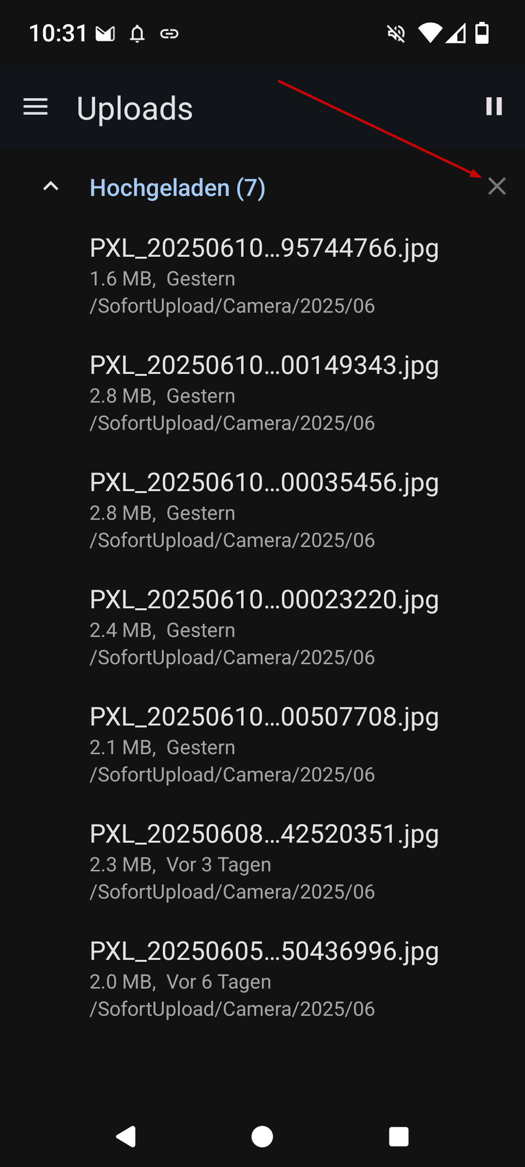

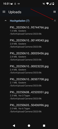

I was able to do that by tapping on the âxâ on the right-hand side of the upload queue. It should look similar to the screenshot below, which shows the files that have already been uploaded:
But that screen wonât open, if there is active queue with thousands files, just like Camera folder hanging the in file explorer.
And that button completely and permanently cancel all operations with files, marking files as uploaded. Not just the current upload task, which iâm talking about.
Had to disable WiFi, kill the process and only then it opened. Removed all uploads with wrong settings, corrected folder name. Now only uploading new files. Checked upload existing files on/off multiple times. Switched the folder on/off. Existing files not uploading. And there is no button to force it. There is only sync now on folder in file explorer context menu, but that is synching with âŠ/Android/media
