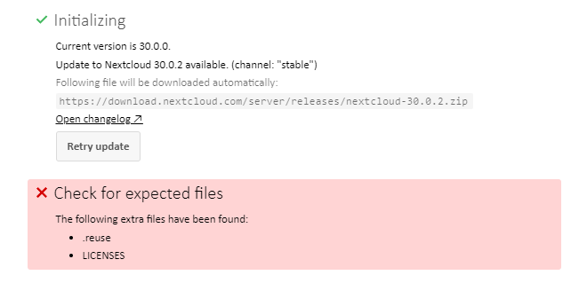

Hello,
I am getting the similar error with my nextcloud instance when I am trying to update from 30.0.0 to 30.0.2. It’s installed on Ubuntu Server 22.04. My extra flies are .reuse and LICENCES. Any help would be much appreciative.
If you realy (realy?) need help to remove those files, you can use the → nc-integrity-fix ← script. That one will help you with the removal.
Much and good luck,
ernolf
Thank you…that worked!!!
