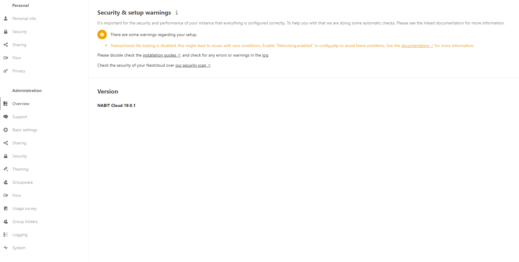

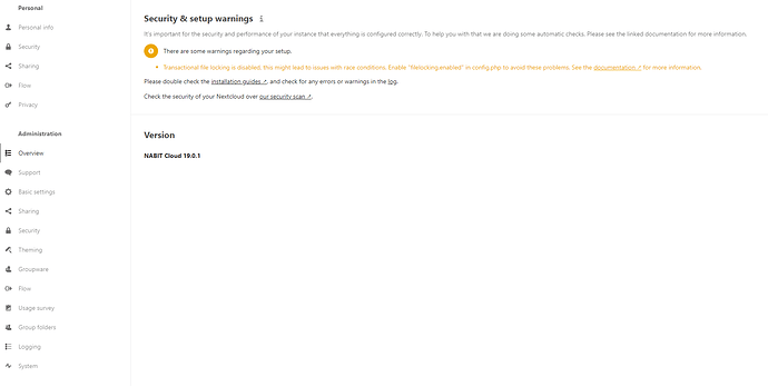

The issue you are facing: When I go to Settings and Overview on one of my nextcloud servers, the Version section shows what version I’m on, but the Updater is gone entirely.
Manually updating works fine. The server is behind a reverse proxy run by my main Apache web server. Am I missing something in the config that could be causing this?
