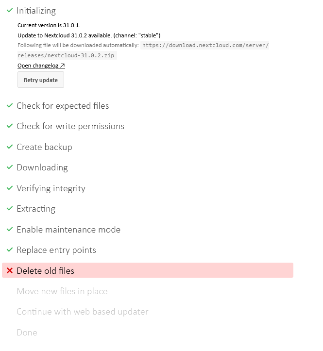

I tried to update my nextcloud installation via the web installer and got this msg:

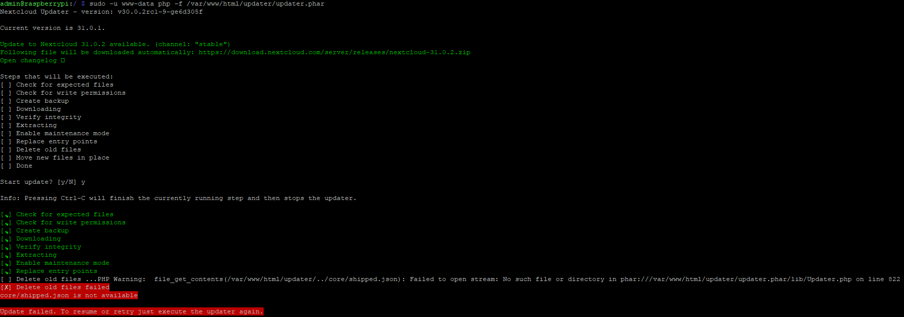

After that i searched the web and did find/execute this command via putty:
sudo -u www-data php -f /var/www/html/updater/updater.phar
I really have no idea how to handle with that core/shipped.json…

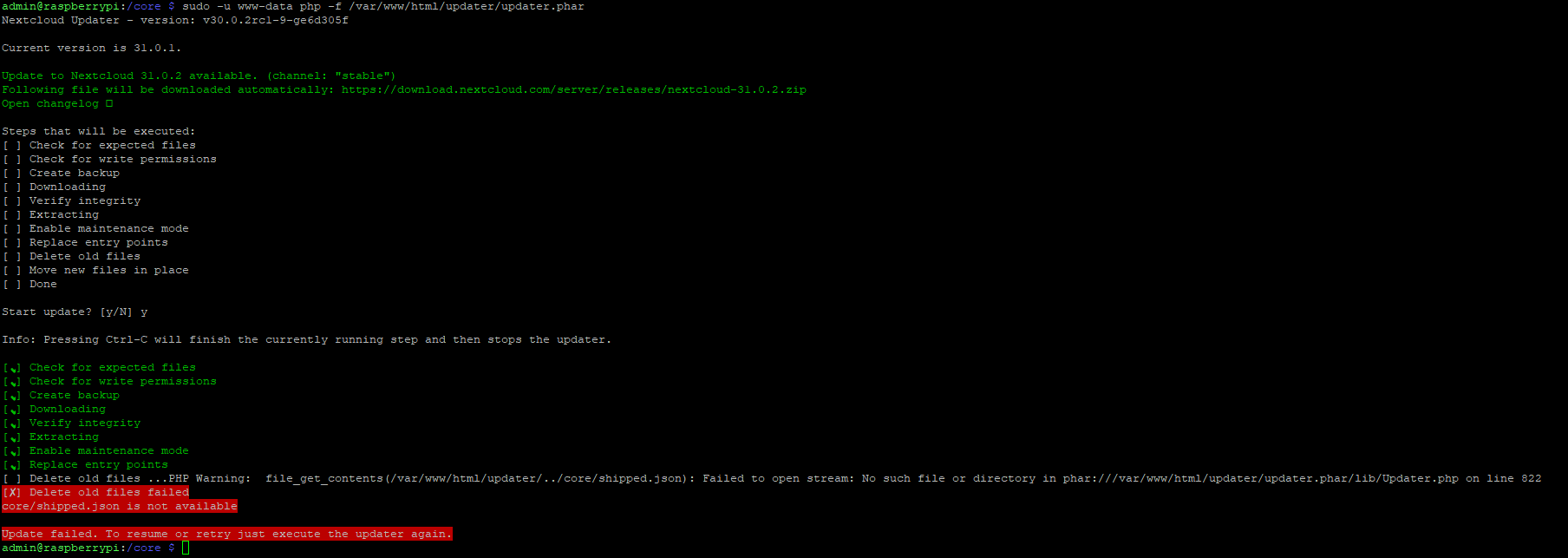

it should work similar to the old solution … download the actual *.tar.gz or *.zip of the nextcloud anbd copy over the missing json file into the /core folder.
Before you re-start the upgrade process again, be sure that all files in place are in ownership of your www-user!
see: Delete old files core/shipped.json is not available - #17 by cptechnik
