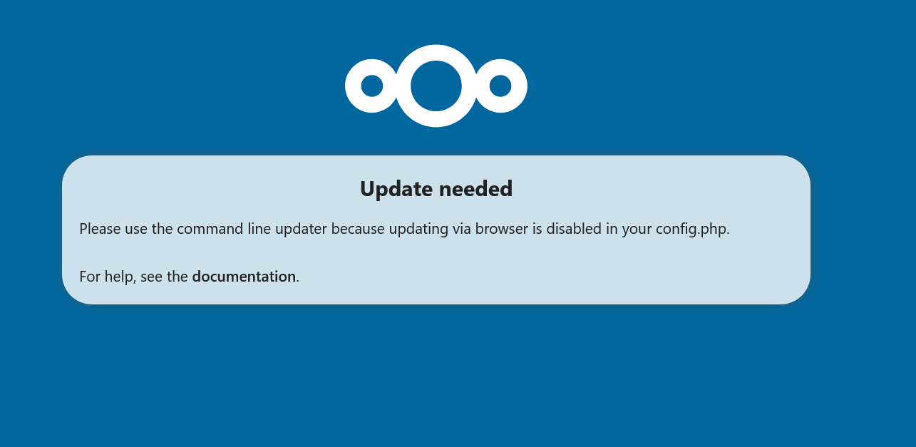

Hello all! I’m off to work, so I’m hoping I’ll be able to find the solution when I get home this afternoon. I updated my calendar app last night and now I’m stuck on this:
Does anyone know where in the documentation I can find the solution? I looked for about 30 minutes and came up empty handed. Thanks!

This page suggests you’re doing more than just upgrading the Calendar app. :wink:
It suggests your Nextcloud Server itself is being upgraded.
The web Updater is likely disabled because the install method you’re using doesn’t use the internal Updater, but relies on some other mechanism to update. For example, Docker images don’t use the Updater so they tend to turn off. You’ll want to follow the update approach documented for the installation method you chose.

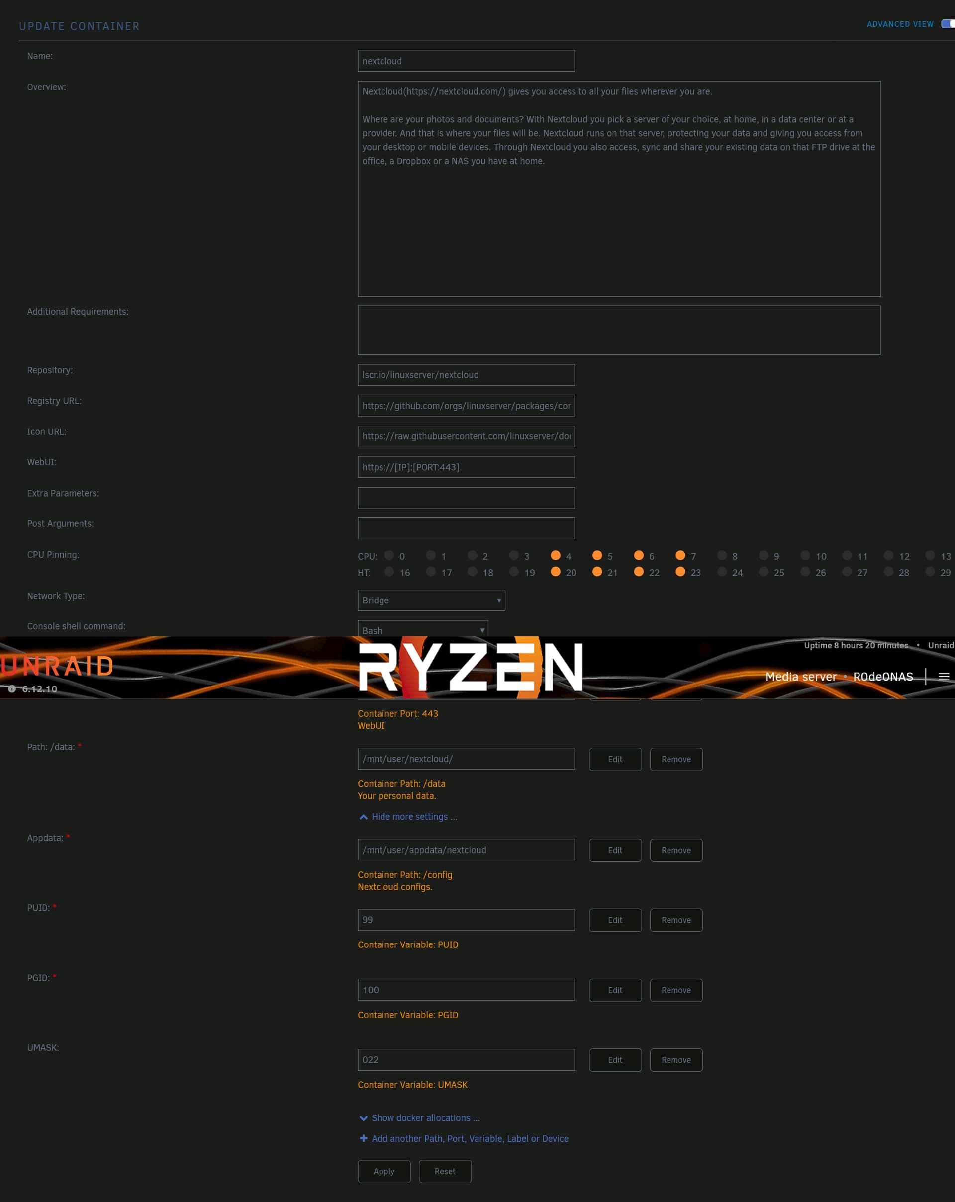

It’s a docker from linuxserver. If I would have known then what I know now, I would have stuck with the official template. Everything is up to date and it was all running fine until I updated my calendar. :sob:
The linux server forums (Procedure to update linuxserver/nextcloud has changed - Docker - openmediavault) state that updates can only be done from inside the image. But everything IS up to date.
Can you post your executed docker-commands with output?
I’m not exactly sure what you mean by “docker-commands with output”
Do you mean the template?
I’m still unclear how you updated the Calendar app and then ended up at the Server update screen. Can you describe precisely how you upgraded Calendar? Are you using something like Watchtower that might have upgraded your Nextcloud image/container as well?
